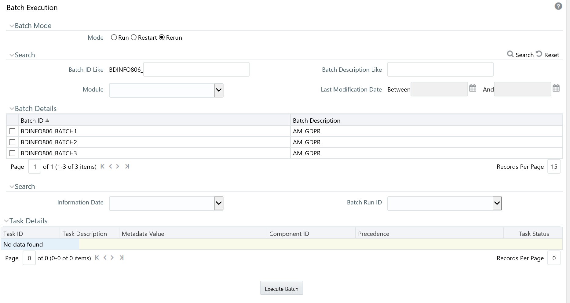

  3. In the Navigation List, select Operations, then click Batch Execution. The Batch Execution page is displayed.
  4. Select Rerun from the Batch Mode section.
  5. Select the batch from the Batch Details section that you want to rerun.
  6. Select the Information Date and Batch Run ID for the selected batch from the drop-down list.
  7. Click Execute Batch.
