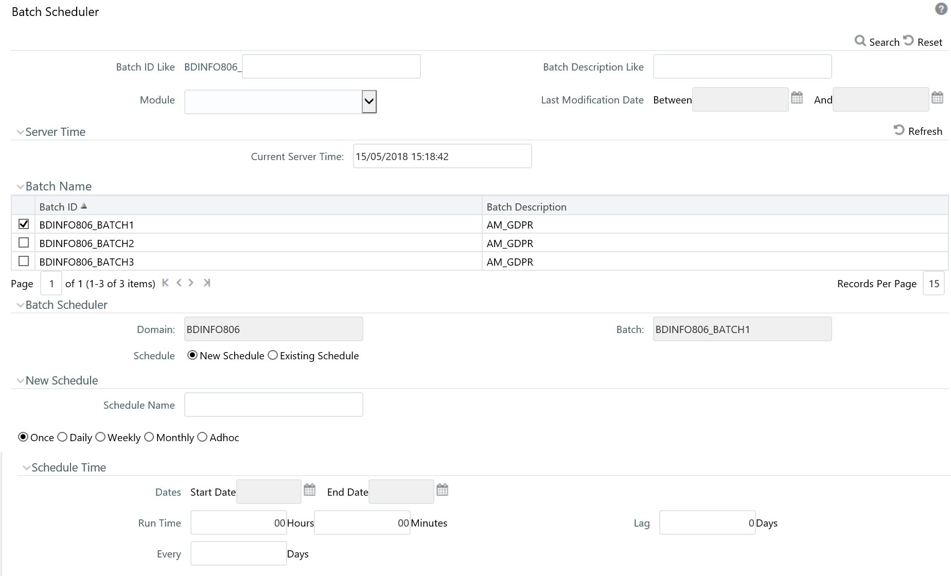

5.6.7 Scheduling a Batch Once To schedule a batch that you want to run daily, follow these steps: Login as the Administrator. The OFSAAI Applications page is displayed. Click Trade Based Anti Money Laundering. In the Navigation List, select Operations, then Batch Scheduler. The Batch Scheduler page is displayed. Select a batch that you want to schedule from the list of available batches. The Batch Scheduler section is expanded and displays additional options. Click New Schedule. Set the frequency of the new schedule as Daily. Enter the schedule time of the batch by specifying the Dates, Run Time, and Every information. Figure 5-9 Scheduling a Daily BatchDescription of "Figure 5-9 Scheduling a Daily Batch" Click Save. The batch will run at the specified date and time.
