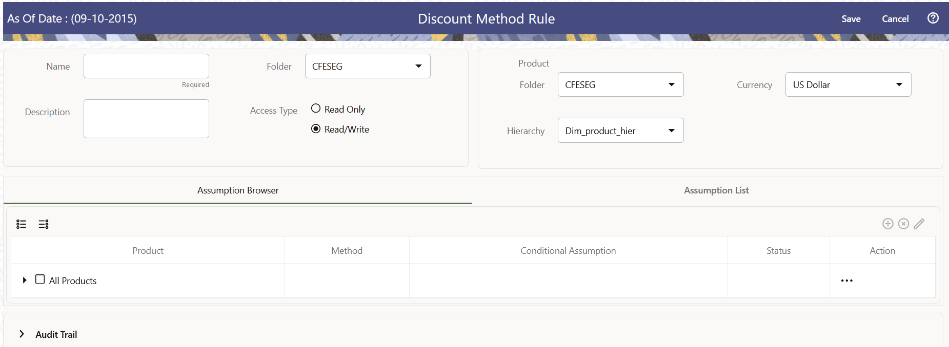

  2. Click Add. The Discount Method Rule Page is displayed.
    Figure 2-2 Discount Method Rule
  3. Enter the following details:
    Table 2-4 Discount Method Details
    Fields Description
    Name Enter the name of the Discount Method Rate Rule.
    Description Enter the description of the Discount Method Rule. This is an optional field.
    Folder Select the Folder where the Discount Method Rule needs to be saved.
    Access Type Select the Access Type as Read-Only or Read/Write.
