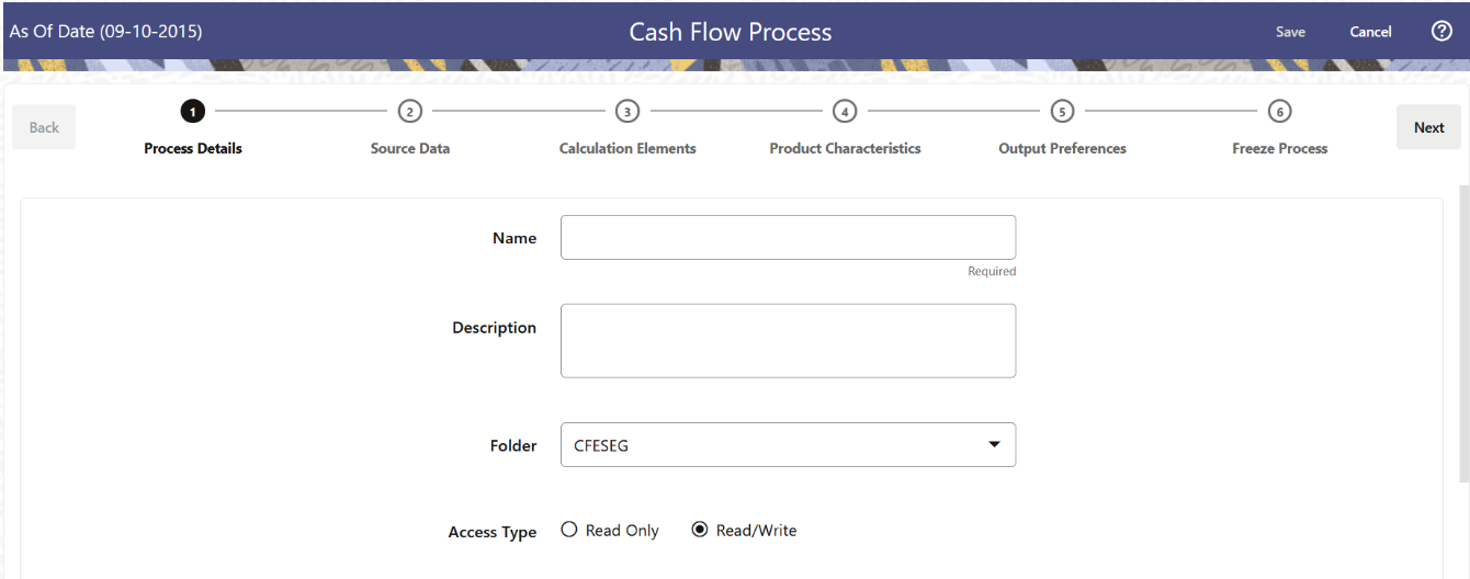

2.3 Create Cash Flow Process
To create a new Cash Flow process, perform the following steps:
  1. Navigate to the Cash Flow Process Summary page.
  2. Click Add . The Create Cash Flow Process page is displayed.
    Figure 2-2 Cash Flow Process Window
  3. Enter the details in the Process Details section.
    Table 2-3 List of process details used for Creating Cash Flow Process
    Parameter Description
    Name Enter the name of the Cash Flow Process .
    Description Enter the description of the Cash Flow Process .
    Folder Select the Folder where the Cash Flow Process needs to be saved.
    Access Type Select the Access Type as Read-Only or Read/Write.
    Figure 2: Cash Flow Process
