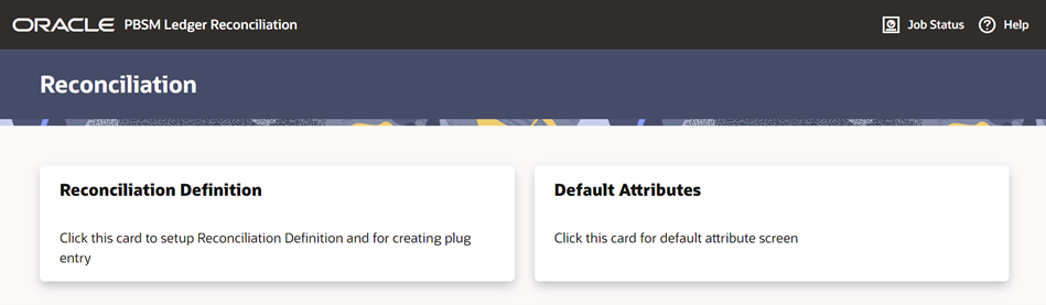

To access the Balance Reconciliation module, from the LHS Menu, navigate to Data Management Tools, and select Balance Reconciliation.
The Balance Reconciliation landing screen displays the following two cards:
  • Reconciliation Definition
  • Default Attributes
Figure 4-45 Reconciliation Landing Screen
The Reconciliation landing screen displays the Reconciliation Definition and Default Attributes cards.
