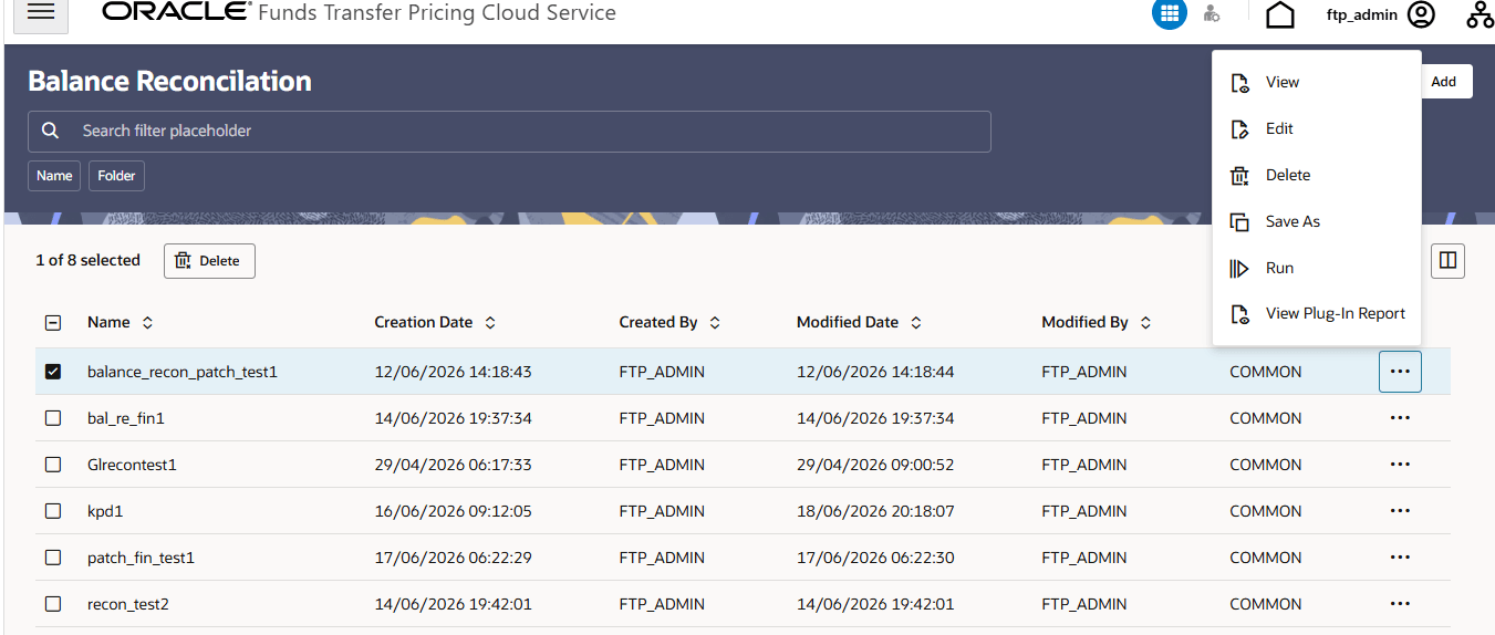

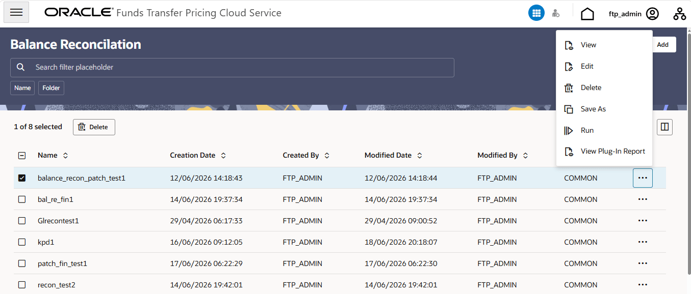

The following screen display the Actions menu from which the different actions that you can perform on existing Reconciliation Definitions.
Figure 4-52 Actions Icon and Different Actions
The following are the actions:
  • View: Click this action button and view the definition in read only format.
  • Edit: Click this action button and edit the definition.
  • Delete: Click this action to delete the selected definition.
  • Save As: Click this action to create a new definition by copying the selected definition.
  • Run: Click this action to execute the reconciliation based on the selected parameters.
    As-of-Date is a run time parameter, you can choose for which date reconciliation needs to be performed.
  • View Plug-In-Report: Click this action to view the generated Reconciliation Report for the selected run.
  • Execution Details: Click this action to view all the runs for a selected definition, along with the user information of who triggered the execution.
    The View Plug-In-Report option displays the generated Plug-In-Report for the selected reconciliation run.

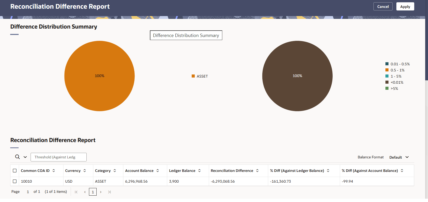

    After clicking Process, the Reconciliation Difference Report is generated. You can also access the generated report using the View Difference Report option available from the More menu on the reconciliation definition screen.
    In the View Difference Report screen, placeholder dimension columns are visible along with the selected reconciliation dimensions. These columns are displayed in the report output to support reconciliation analysis across activated placeholder dimensions.
    Figure 4-53 Reconciliation Difference Report
    The detailed report is displayed as follows, where you can filter out insignificant difference using ‘Threshold Percentage’, also threshold can be applied at each row level or for whole Balance Sheet category level. If threshold is applied at Balance Sheet category level, all the rows that belong to the Balance Sheet category which is less than given percentage will be hidden from the Reconciliation Difference Report. A download button allows you to download the Reconciliation Report.
    You can select Filter at Category Level toggle switch to apply threshold at ‘consolidated difference reports’, which is at balance sheet category level OR can directly apply the threshold to each difference row, which is available at the unique combination of selected key dimensions.
    You can select the ID / Code toggle switch to see the CD data. By default, the toggle switch displays the ID data.
    You can also change the unit of balance to thousands or millions.
    You can see difference in both percentage and absolute format.
    Figure 4-54 Differences in Percentage and Absolute Formats

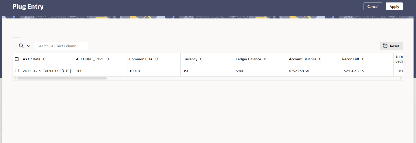

    As a next step to create the plug entries for filtered rows, you can click the Apply button in extreme right corner. Following a grid appears, along with default attributes fetched from default product attributes: if you like, you can update any of these attributes before plug entries are created for the selected difference records. You can use the Edit and Save button to edit the default product attributes like Amortization Type, Interest Rate Code, and so on. You cannot edit any Code (CD) or VARCHAR attributes. Only attributes like Number, Rates, Dates, Term can be edited. All types of balances like Org balance, Current/Average balance are same as the reconciliation difference.
    After you are convinced with the entered values for all the account attributes, you can click Apply. A job will be submitted and plug entries will be created in the FSI D Ledger Instruments table. To differentiate the plug entries from the customer real accounts, Data source CD will be used, with value 3, which signifies the ‘Difference balance entries due to reconciliation performed between account and ledger’.
    Figure 4-55 Differences in Percentage and Absolute Formats
    Figure 4-56 Plug Entires
    Plug Entires
Viewing the Plug-in Report
After the Balance Reconciliation run is completed, users can view the generated report from the action menu.
To view the report:
  1. Navigate to the Balance Reconciliation Summary screen.
  2. Select the completed Balance Reconciliation definition or run for which you want to view the report.
  3. Click the Action menu icon for the selected row.
  4. Select View Plug-In Report.

Running a Balance Reconciliation Definition
Use the Run option to execute a Balance Reconciliation definition.
To run a Balance Reconciliation definition:
  4. Select Run.
    Figure 4-58 Run Option
    Run Option
