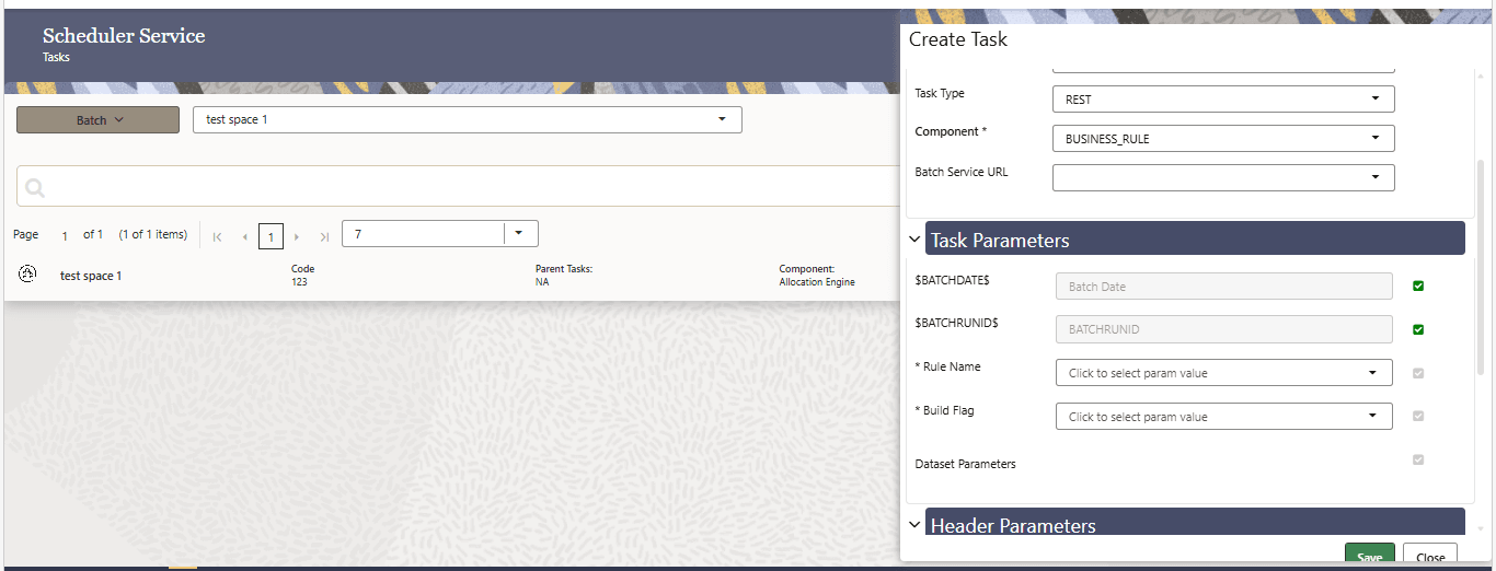

- In the Create Task screen, enter the following values:
- Task Code (Spaces are not allowed in the code section). b.
- Task Name.
- Select the task type as REST.
- Select the Component as BUSINESS_RULE..
- Click Save.
When the BUSINESS_RULE. component is selected, the Batch Service URL field is not displayed and does not require configuration.Figure 4-80 Define Task
- In the Task Parameter section, enter the following values:
- Rule Name — Select the Business Rule that must be executed.
- Build Flag — Select whether the Business Rule must be built or compiled before execution.
- Dataset Parameters — Enter or review the dataset-specific parameters required to execute the selected Business Rule.
Figure 4-81 Define Task
