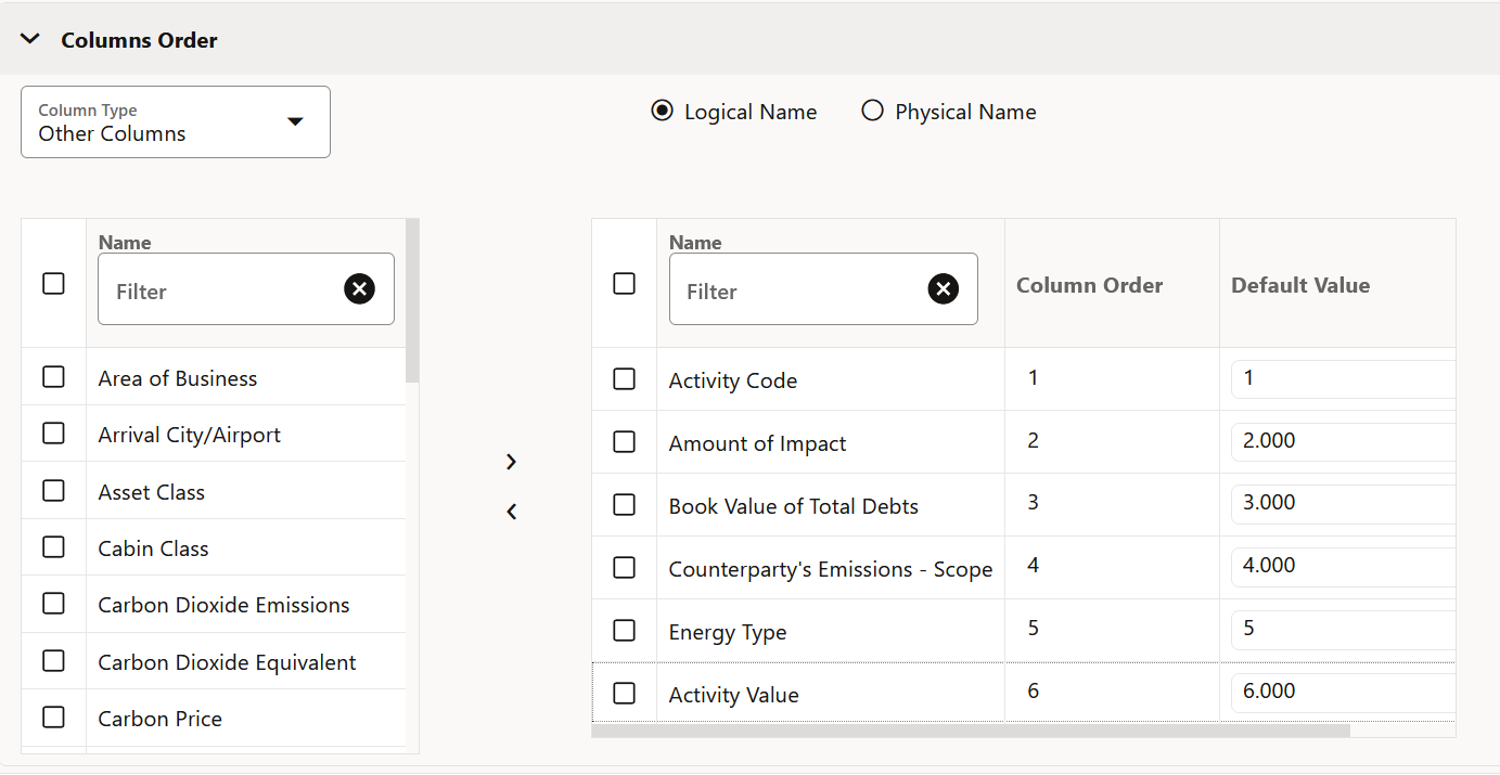

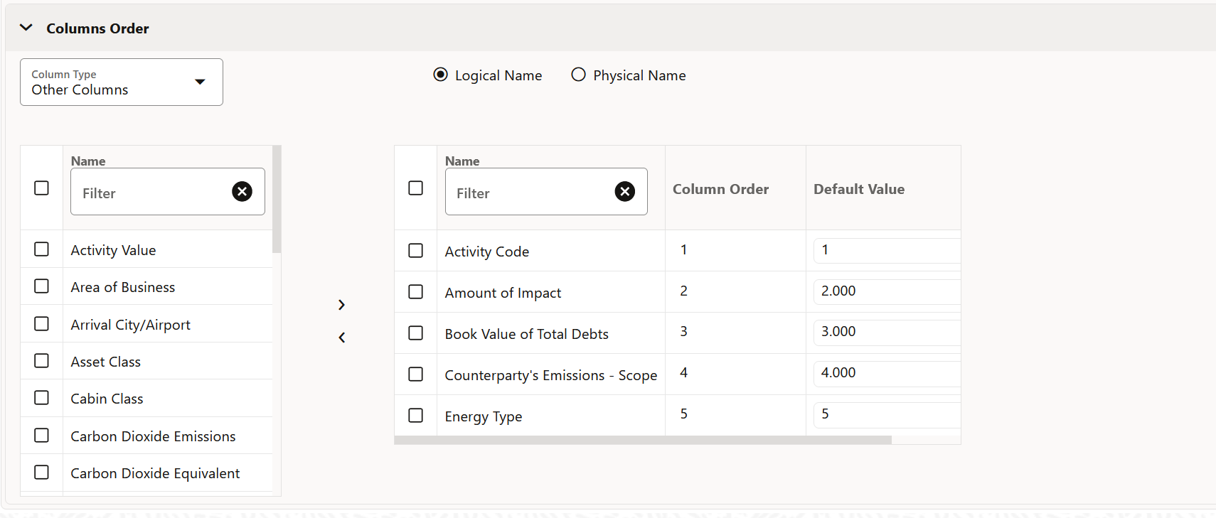

Within the selected Column Type, Column Names can be re-ordered by dragging and dropping. The columns are always ordered by their type, that is, Key Columns will appear before the Dimension Columns and Dimension Columns will always appear before the Other Columns. After saving a definition, if you add a new Dimension Column then it will appear in the order before the remaining Other Columns. For example, assume that the initial definition is saved with the below columns:Figure 6-3 Column Preview
After this, if a new Dimension Column (say Product Id) is selected, it will push the Other Columns down in order.Figure 6-4 Column Preview
The same order must be followed while preparing the Data File.
