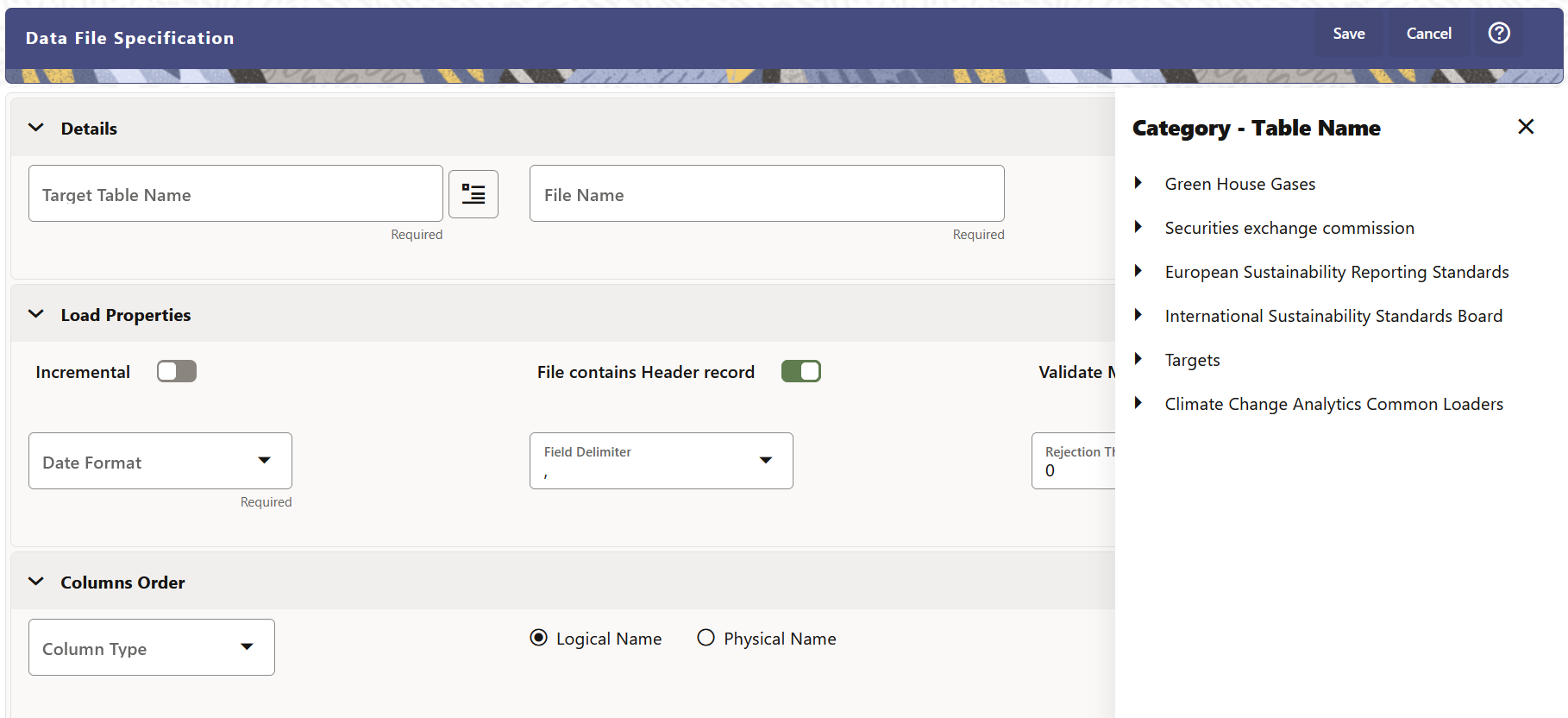

  1. Navigate to the Data File Specification Summary Page and click the Add icon to open the Data File Specification window.
    Figure 5-2 Data File Specification
    This image displays the Data File Specification window where you can create a Data File Specification.
  2. Under the Details Section of the screen, enter the following details:
    1. Click on Target Table Name to open a list Category – Table Names. The tables are categorized into different groups and are as follows:
      • Green House Gases
      • Securities Exchange Commission
      • European Sustainability Reporting Standards
      • International Sustainability Standards Board
      • Targets
      • Climate Change Analytics Common Loaders
      Each of the above Categories lists the Tables available for data loading. The list of categories is dependent on the Metadata from the Seeded Tables that come with the various OFS CCA Cloud Services and may differ from that shown above based on the services you have subscribed to.
    2. Select a Table from the list for which you want to create the Data File Specification.
    3. Enter a unique Name for Data File Specification with an extension of the file format. The formats supported are TXT, CSV, and DAT types.

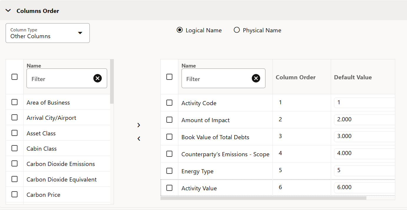

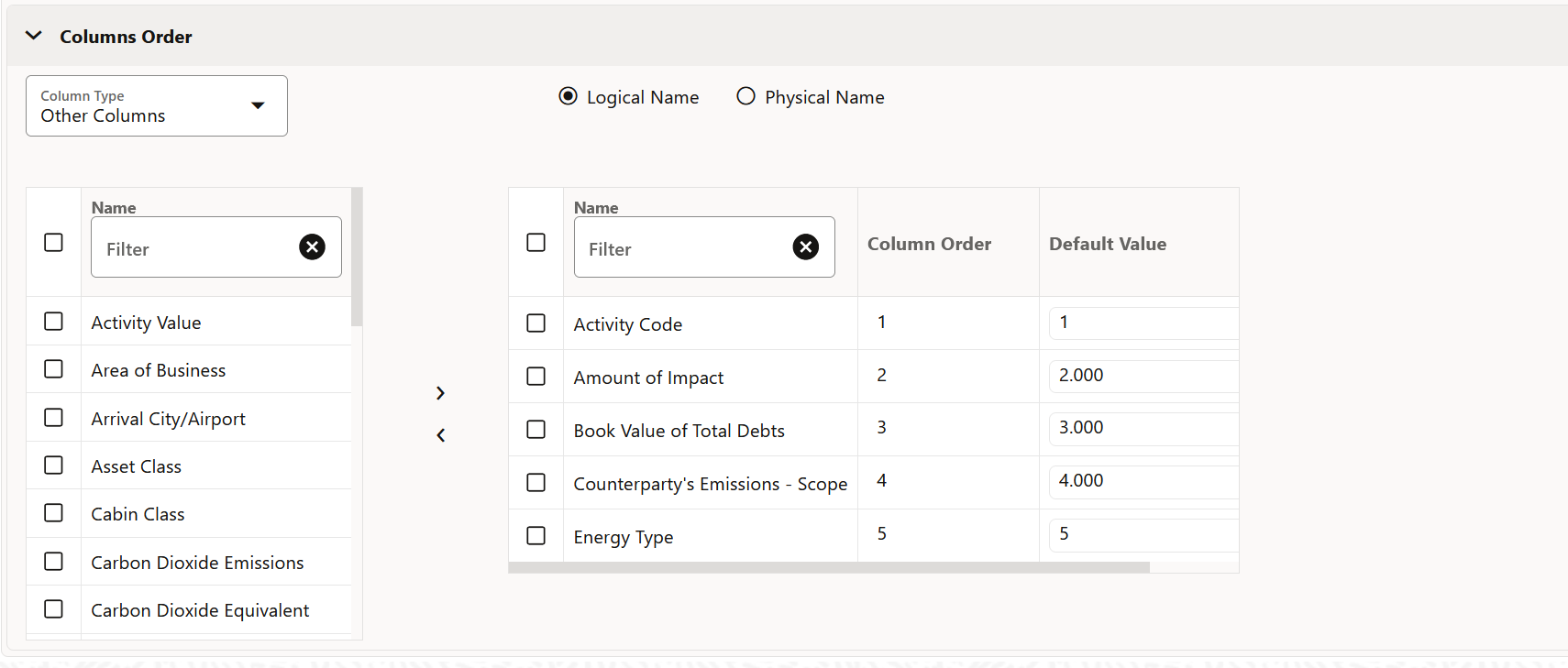

      Within the selected Column Type, Column Names can be re-ordered by dragging and dropping. The columns are always ordered by their type, that is, Key Columns will appear before the Dimension Columns and Dimension Columns will always appear before the Other Columns. After saving a definition, if you add a new Dimension Column then it will appear in the order before the remaining Other Columns. For example, assume that the initial definition is saved with the below columns:
      Figure 5-3 Column Preview
      This image illustrates the list of columns.
      After this, if a new Dimension Column (say Product Id) is selected, it will push the Other Columns down in order.

      The same order must be followed while preparing the Data File.
      The default value for each Column can also be given in the table. If the Column Value is null in the Data File, then the default value is used.
