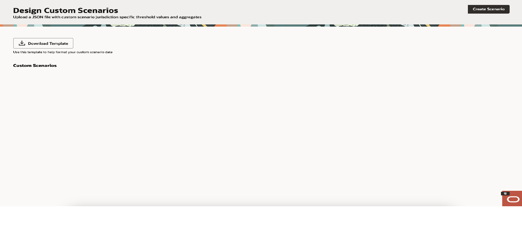

You may skip creating a custom scenario in the initial configuration by using the Skip button.
To design a new custom scenario during initial configuration, follow these steps:

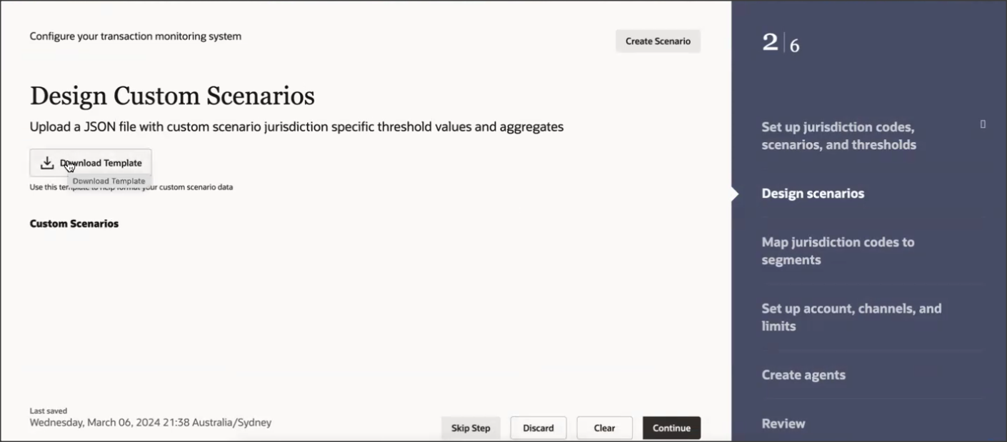

  1. Click Download Template. A JSON template is downloaded.
    Currently, a single JSON file can be used to configure a scenario for only one risk segment. If a scenario has to be configured for three risk segments, for example, BCAP_RR, BCAP_MR, BCAP_HR, three different JSON files are required with three different scenario names. For sample files, see Sample Template

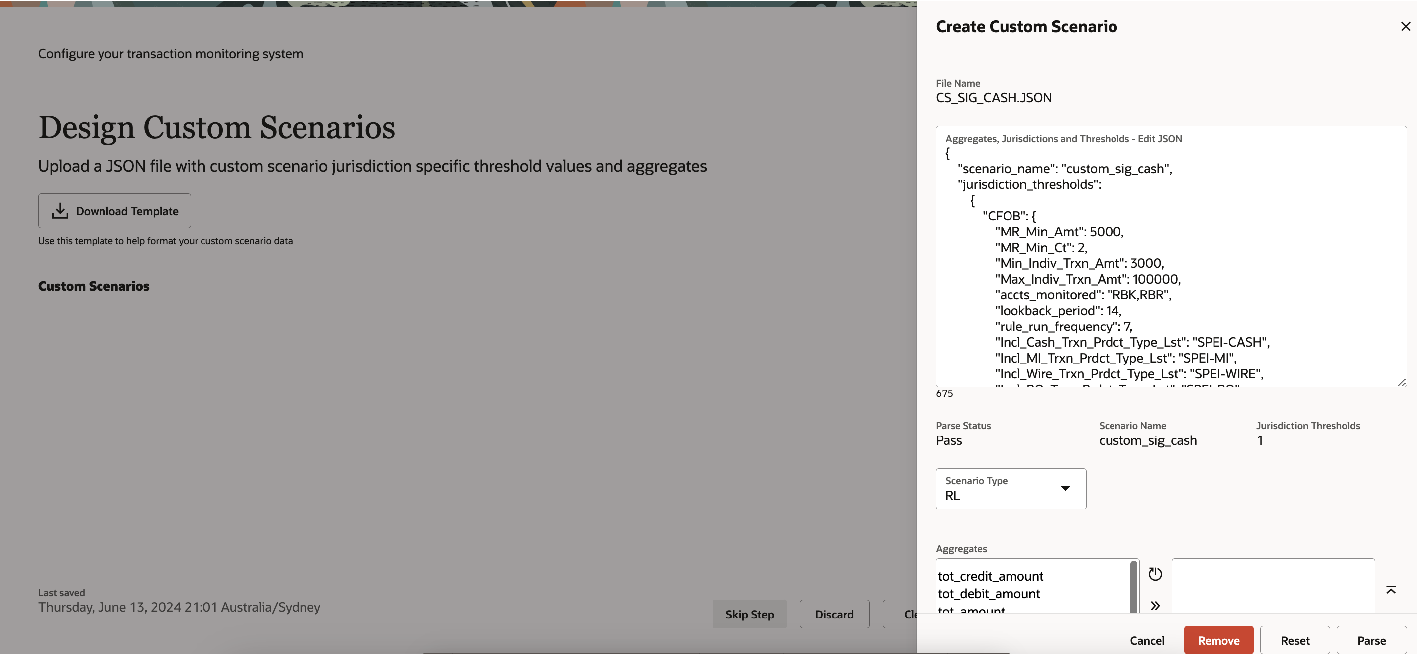

  3. Click Create Scenario. Drag and Drop the required JSON template. The selected JSON template details are displayed.
    Figure 3-21 Create Custom Scenario
  4. Select the scenario type RL or HT from the Scenario Type drop-down list. The list of aggregates for RL and HT are available in the Aggregates List section.
    • RL - RL stands for "Risk and Liability" experiments, which are used to evaluate the overall strength and performance of the system. Scenarios added using this option will be used to assess the system's performance and identify any potential risks or liabilities.
    • HT - HT stands for "Human Trafficking" experiments, which are used to evaluate the system's performance specifically against the Human Trafficking typology. Scenarios added using this option will be used to assess the system's effectiveness in detecting and addressing specific Human Trafficking risks.
  5. Based on your selection, a relevant list of aggregates is displayed. Select and move the required aggregates to the right-hand side box.
  6. Enter scenario conditions in the Custom Scenario Condition box using thresholds and aggregates.
    When entering scenario conditions, only a single space must be used between each term in the expression. It is mandatory even when parentheses are used.
    • Correct: (Total_Trxn_Amt >= RR_Min_Total_Amt ) and (Total_Trxn_Ct >= RR_Min_Total_Ct )
    • Incorrect: (Total_Trxn_Amt>=RR_Min_Total_Amt) and (Total_Trxn_Ct>=RR_Min_Total_Ct)
  7. Click Parse to validate the condition. If the validation is successful, the parsing will be passed.
  8. Click Accept to add the newly created scenario. This scenario will be listed on the Custom Scenario page.

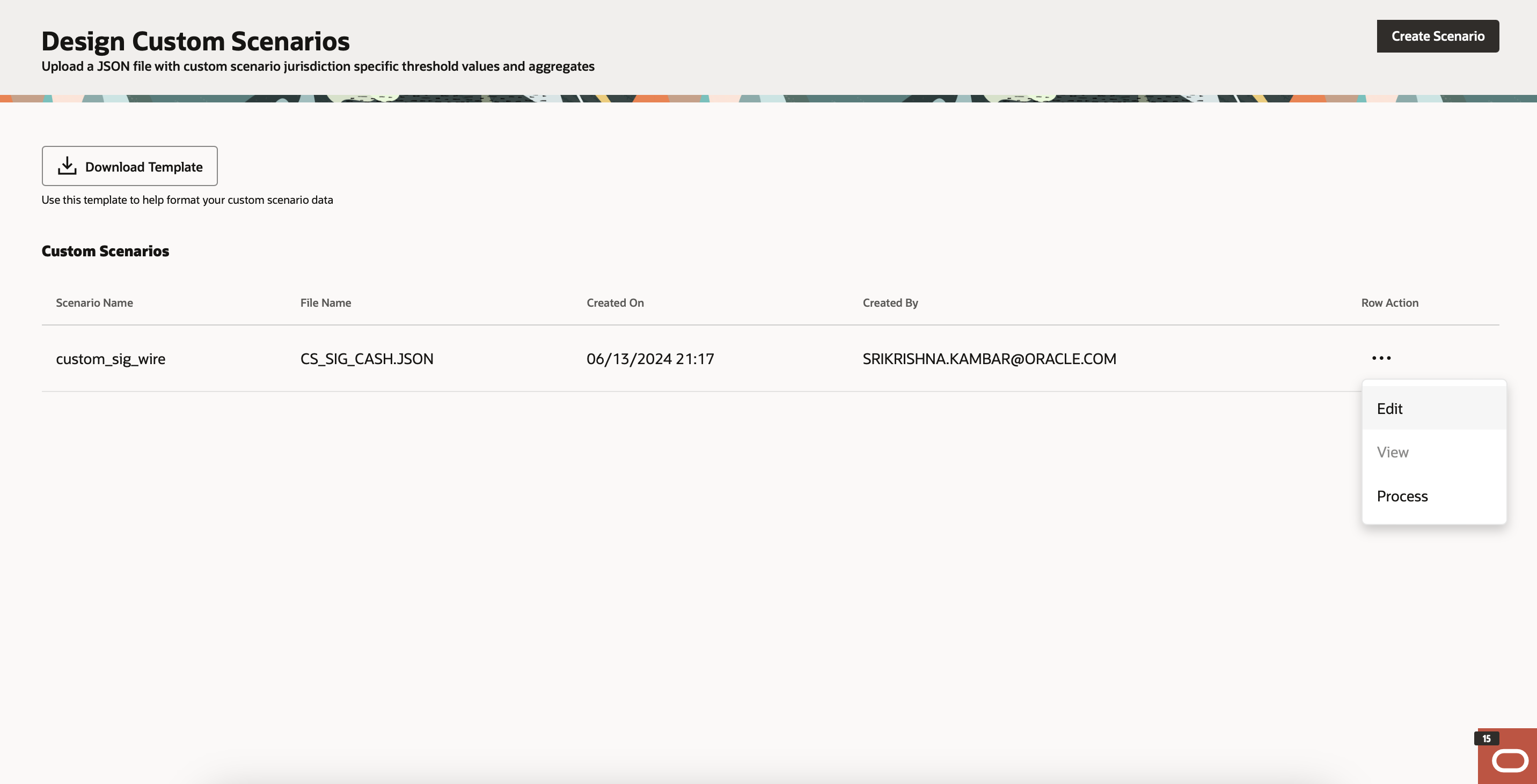

  12. Click … Option Icon and then click Process. A new custom scenario is created. You can also modify the scenario using the Edit option.
    Once you process the scenario, you cannot edit it.

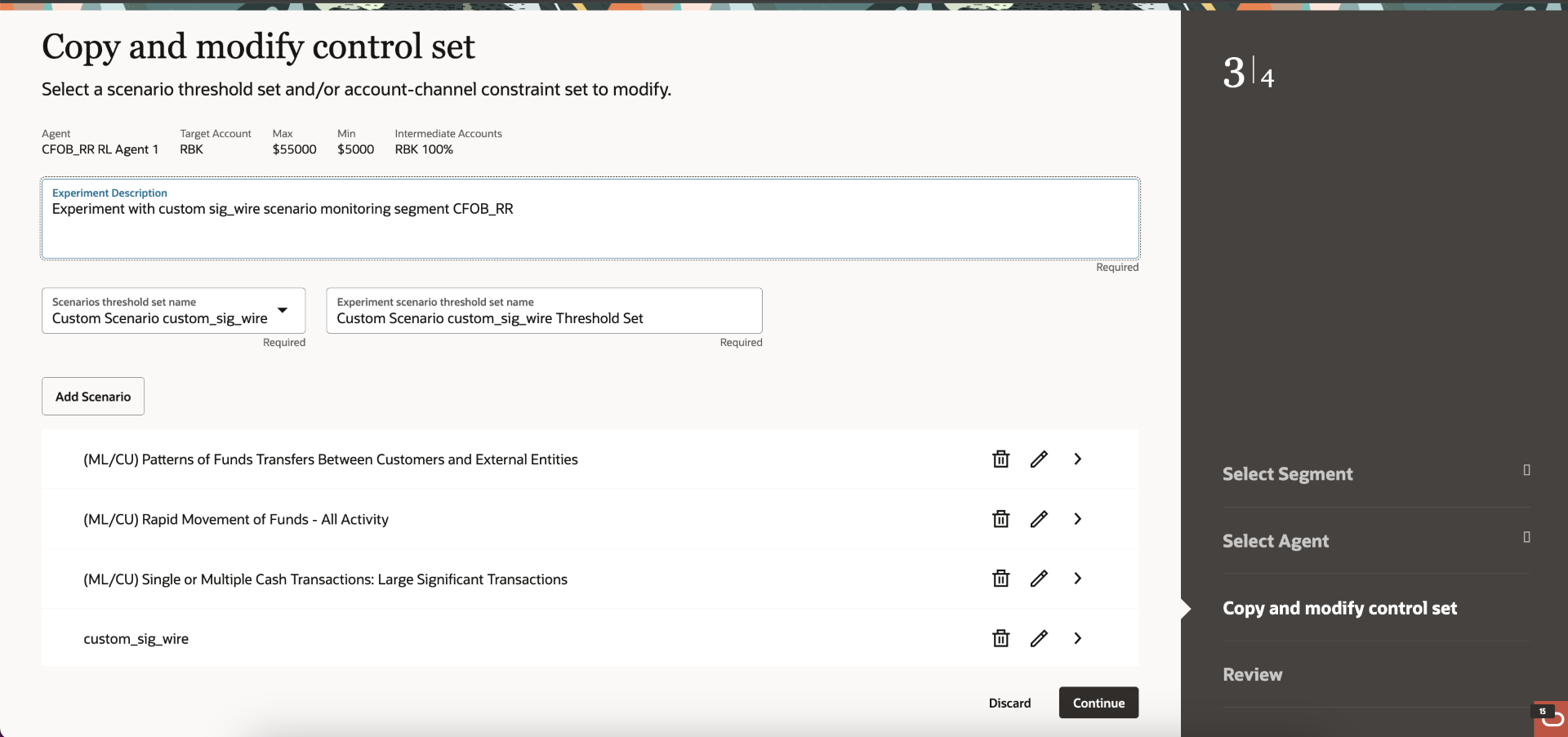

    The New Scenario will be available as part of a New Threshold Set with the current Production Controls, which can be used while creating experiments in that segment.
    You can perform the following activities using the Row Action.
    • Edit - The Edit option allows you to modify the existing information of a scenario. This option is used when you need to make changes or updates to the scenario's details.
    • View - The View option allows you to view the scenario without making any changes. This option is useful when you want to review the scenario or gather information from it.
    • Process - The Process option is used to create a custom scenario. This option enables you to define and set up a new scenario according to your specific requirements.
