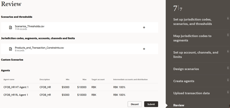

3.2.7 Review
In this section, you can view the uploaded data and created agents for each of the segments.

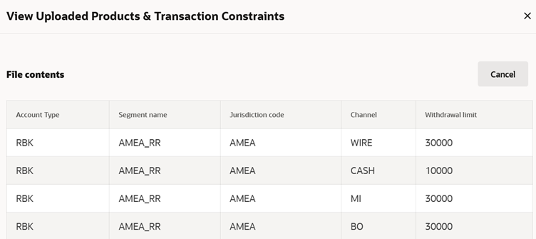

  1. Click the View icon view icon in Jurisdiction codes, segments, accounts, channels, and limits to view the uploaded products and transaction constraints. The following window is displayed.
    Figure 3-40 Uploaded Products and Transaction Constraints

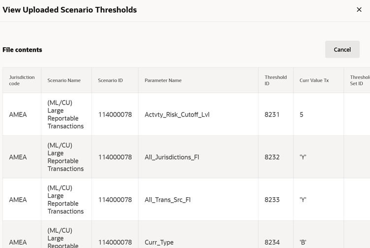

  3. Click viewthe View icon in Scenarios and thresholds to view the uploaded scenario thresholds. The following window is displayed.
    Figure 3-41 Uploaded Scenario Thresholds

  5. Click Submit to configure your transaction monitoring system. This will trigger experiment of type "Initial Set Up" for each of the segments you have configured.

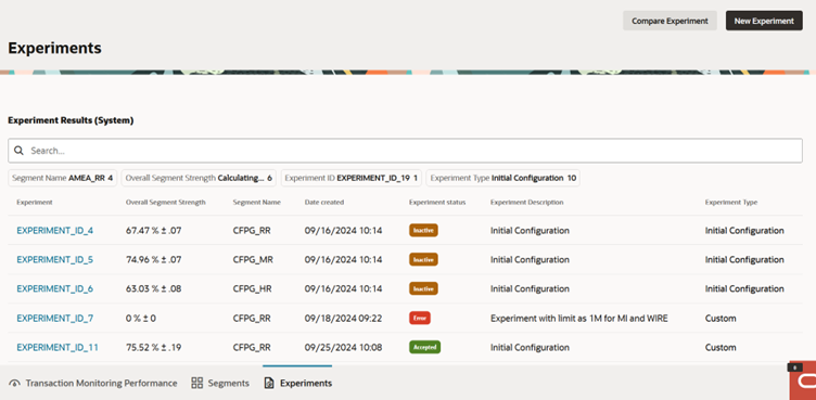

  6. Navigate to the Experiments tab and you can view the created experiment is in In progress status as shown below:

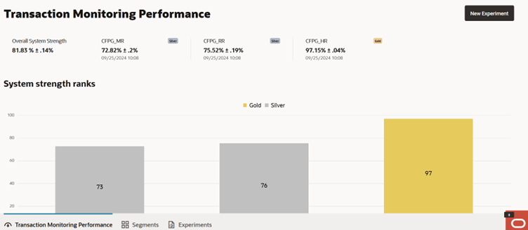

    Once the experiment is completed, the status of the experiment will change from "In Progress" to "Completed". If the experiment has run successfully, the dashboard will be updated as shown below:
    Figure 3-44 Transaction Monitoring Performance

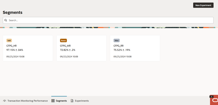

    Navigate to the Segments tab to view the segments.
