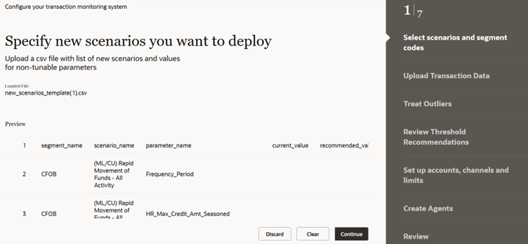

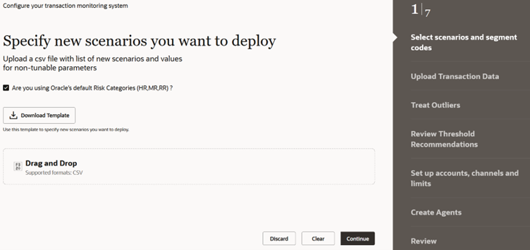

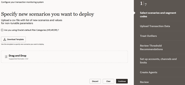

3.1.1 Select scenarios and segment codes
In this step you will need to specify the new scenarios that you wish to deploy and generate recommendation for.
The inputs can now be provided for multiple segments.
Specify jurisdiction codes or segments at your institution, choose the scenarios that will be deployed against each segment.
Upload a csv file with a list of new scenarios and values for non-tunable parameters in a prescribed template. Note that OFSCA does not recommend thresholds for non-tunable parameters which should be informed by the needs of the business and expertise of an institution’s AML subject matter experts.
The template requires filling of details - Segment Name, Scenario Name, Parameter Name,
Current Value, Recommended Value (generated at the end of process), and Tunable Parameter.
