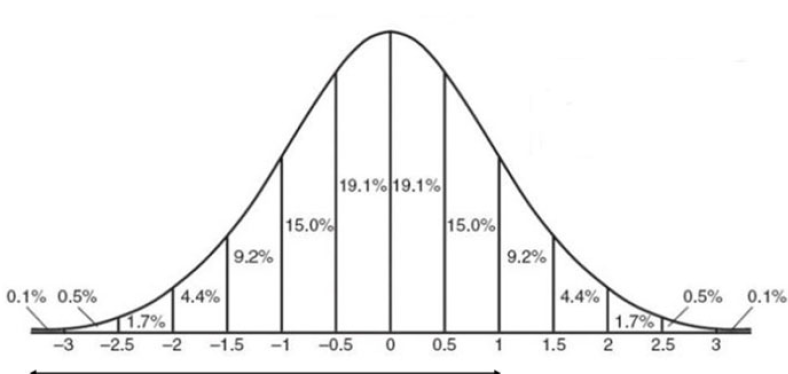

purpose, 85th percentile is recommended as the base percentile below which the
data is assumed to be within acceptable limits and not suspicious. The choice of
85th percentile is based on the distribution statistics of a normal
distribution, where 85% of the data lies within Mean + 1 standard deviation. The
base percentile can be customized to suit the user's preferences.
