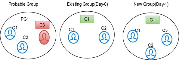

Add
Existing group elements are a subset of probable group elements, and the number of elements in the probable Group is more than the existing Group. Extra elements in the probable Group do not have any global id assigned yet. New elements are added to the existing Group, and the same global id is assigned.
For example, G1 has C1 and C2 entities. After the Day 1 batch execution, if C3 entity ma

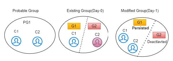

Case 2: If number of entities are same between the groups
For example, G1 has C1 entity and G2 has a C2 entity. After the Day 1 batch execution, if C2 entity matches with an existing group then C2 will be merged into the existing group with same global id is persisted and G2 will be deactivated.
Figure 4-23 Merge Action for Lowest Global ID

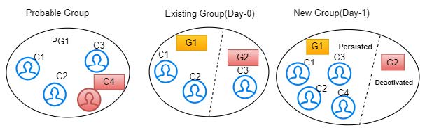

Case 1: If number of entities are different between the groups
For example, G1 has C1 and C2 entities, G2 has C3 entity. After the Day 1 batch execution, if C4 entity is added newly and C3 entity got changed then common entities are merged into a single group and a new entity is added to the group with existing global id (G1 has C1, C2, C3, and C4 entities) is persisted and G2 will be deactivated.
Figure 4-24 Merge and Add Action for most Number of Entities

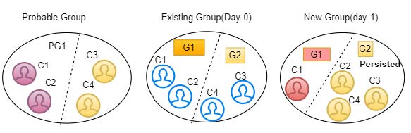

For example, G1 has C1 and C2 entities and G2 has C3 and C4 entities. After the Day 1 batch execution, if C2 matches with C3 and C4 then C2 will be split separately and merged with C3 and C4 respectively. G1 has C1 with a new global id assigned and G2 has C2, C3 and C4 entities with existing global id is persisted.
Figure 4-28 Split and Merge Action for more Number of Entities

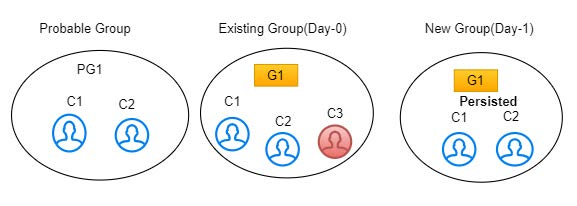

Delete
If an element exists in the existing group, but the same element does not belong to any probable group and does not exist in the customer/entity dataset, it is deleted from the existing group with same global id is assigned to the Group. If the deleted record is part of STG_DELETED_PARTIES_PRE table then underlying customers will also be deleted.
For example, G1 has C1, C2, and C3 entities. After the Day 1 batch execution, if C3 is deleted from the existing group then G1 has C1 and C2 entities with same global id is persisted.
