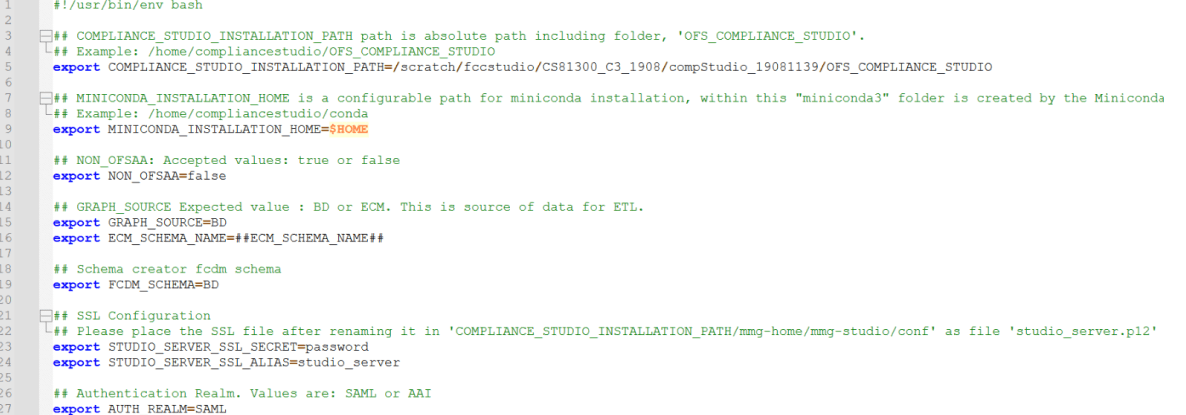

    A sample config.sh file is shown below for reference.
    Figure 2-5 Snapshot of config.sh file
