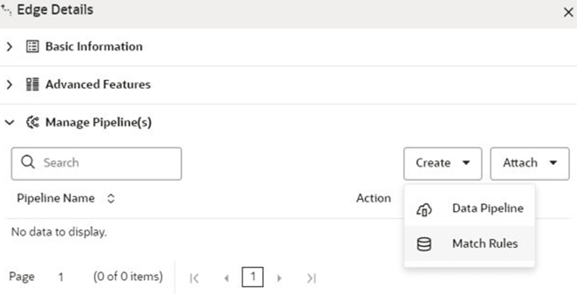

  3. Hover over the graph pipeline and click edge on the graph. The Edge details page is displayed.

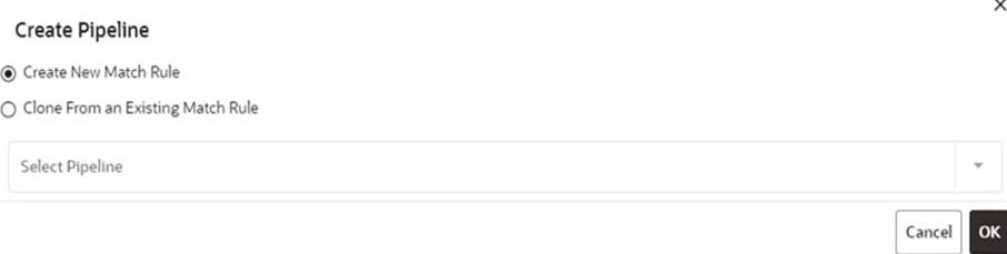

  4. From the Create drop-down list, select the Match Rules. The Create Pipeline window is displayed.

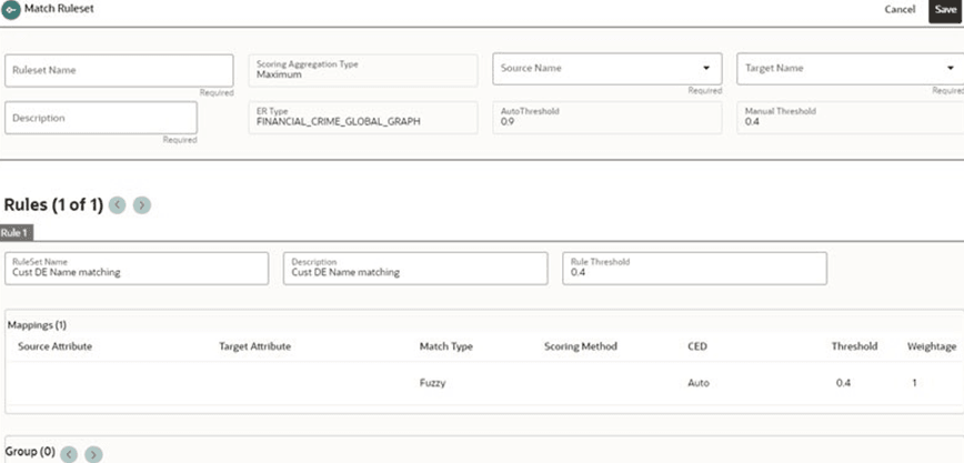

  5. Select Clone From an Existing Match Rule option and required pipeline from the Select Pipeline drop-down list and then click OK. The Match Ruleset window is displayed.
    Figure 9-10 Match Ruleset Details
  6. You can enter/select the Ruleset details for the following fields:
    • Ruleset Name
    • Source
    • Target
    • Description
    For information on the fields in the Ruleset Details window, see the Creating Match/Merge Ruleset section.
    For cloning an existing match rule, the selected source and target attributes must be same as the source and target attributes of the existing match rule.
