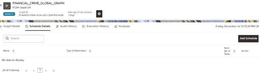

  5. Click Schedule Details tab.
  6. To edit the schedule of the graph, click Edit under Actions column.
  7. Click Add Schedule to add a new schedule.

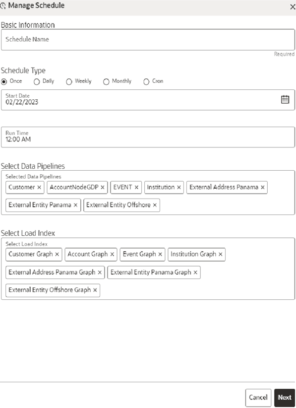

    Figure 9-41 Add Schedule Window
  8. On the Add Schedule screen, select all the tasks and click Next.
    For more information on how to select/enter the parameters, see Schedule Details section.

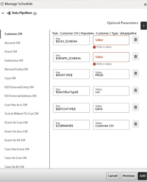

  9. Update the value for “$BD_SCHEMA” or “$ECM_SCHEMA”, “$GRAPH_SCHEMA” in the selected task(s) where the value will be respective schema wallet alias. For “$GRAPH_DS”, where the value will be datasource of the graph schema that is attached to the Compliance Studio workspace.
    Figure 9-42 Data Pipeline Parameter
    For BD graph, $BD_SCHEMA must be selected as the key value for the optional parameter. Similarly, for ECM graph, $ECM_SCHEMA must be selected as the key value for the optional parameter.

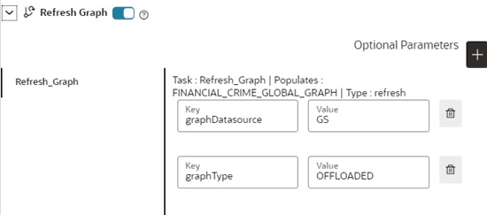

  10. Enable the Refresh Graph option and click Add icon to refresh the Graph to add optional parameters.
    Figure 9-44 Refresh Graph Parameter
    You can configure the respective key-value in the Value field as required and specified in the following table.
    Table 9-15 Parameter for Refresh Graph
    Name Description Default Value
    graphDatasource Datasource of the graph schema that is attached to the Compliance Studio workspace. -
    graphType Execution Graph Type. Available types are OFFLOADED and IN-MEMORY.
    • IN-MEMORY: It collects all the data from the nodes and edge tables and it will be transformed into the Oracle Graph Analytics Engine (PGX).
    • OFFLOADED: It creates only metadata of the executed PGQL query instead of loading the entire graph into the PGX server.
      For more information about offloaded graph type, see the Using Off loaded Subgraph section.
    OFFLOADED
