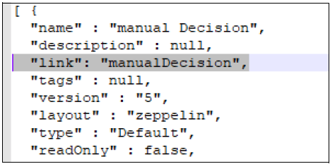

    You can perform the following steps as a workaround:
    Export the "Manual Decision" Notebook.
    Add the link parameter just below Description.
    For example: "link": "manual Decision",
    Truncate the table “fcc_er_paragraph_manual" in Studio Schema.
    Import the modified notebook again.

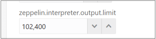

  9. What should I do when the result set is truncated if the size goes above '102400' bytes?
    Perform the following steps:
    Login to Compliance Studio.
    Navigate to interpreter zeppelin.interpreter.output.limit.
    Figure 4-2 Interpreter zeppelin parameter
    Description of Figure 4-2 follows
    Description of "Figure 4-2 Interpreter zeppelin parameter"
    Set the value to the required size.
    Restart the Studio Application.

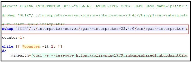

    2. Navigate to the <COMPLIANCE_STUDIO_INSTALLATION_PATH>/deployed/mmg-home/mmgstudio/bin directory.
    3. Open the startup.sh file and add the following line before the line containing “counter=1”;
      nohup <path_to_interpreter_binary_file> &>> <path_to_save_the_logs>/ <log_file_name>.log &
      Figure 4-3 Snapshot of startup.sh file
      Description of Figure 4-3 follows
      Description of "Figure 4-3 Snapshot of startup.sh file"
    4. Save and close the file.

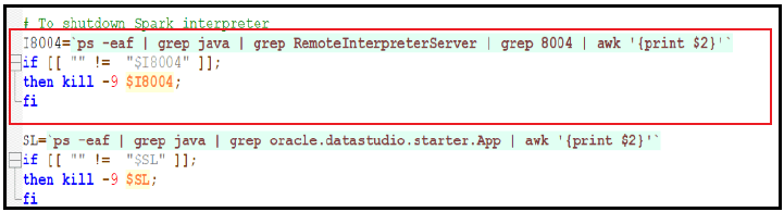

    5. Open the shutdown.sh file and add following line before the line containing “SL=”.
      I8004=`ps -eaf | grep java | grep RemoteInterpreterServer | grep 8004 | awk '{print $2}'` if [[ "" != "$I8004" ]]; then kill -9 $I8004; fi
      Figure 4-4 Snapshot of shutdown.sh file
      Description of Figure 4-4 follows
      Description of "Figure 4-4 Snapshot of shutdown.sh file"
      In the above steps, the port number for the new/cloned interpreter is assumed to be 8004, the default port that comes with the installer. If a different port is used, then change the configuration accordingly.
    6. Save and close the file.
