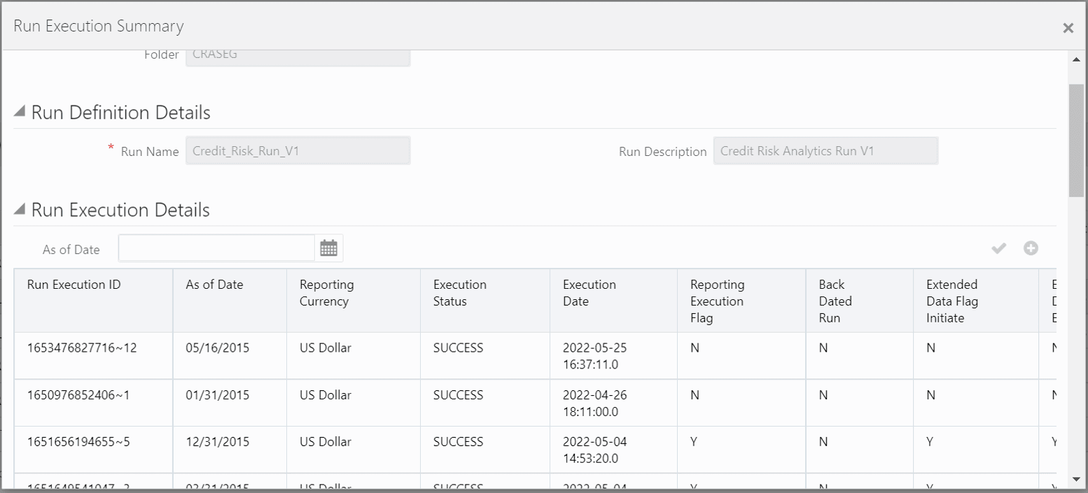

To view the summary of all the Run executions for a particular Run:
  1. Select the Run from the list of Runs in the Run Management Summary window and click Run Execution Summary.
    The Run Execution Summary window is displayed as follows:
    Figure 5-3 Run Execution Summary
    This image displays the Run Execution Summary.
    All the parameters entered as part of the Run Definition window are displayed in the Run Execution Summary window in an uneditable form. The Run Execution Details section displays the Run Execution Parameters specified for each execution.
    You can filter the Run executions by As-of-Date.

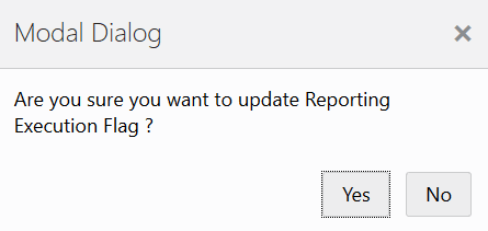

  2. Select a successful Run Execution ID and click Reporting Execution Flag to report it for execution.
    A confirmation message appears before updating the Reporting Flag.
    Figure 5-4 Reporting Execution Flag
    This image displays the Reporting Execution Flag.
    Figure 5-5 Modal Dialog
    This image displays the The List of Reporting Run Execution per As-of-Date Section displays the Modal Dialog.
    a. Click Yes.

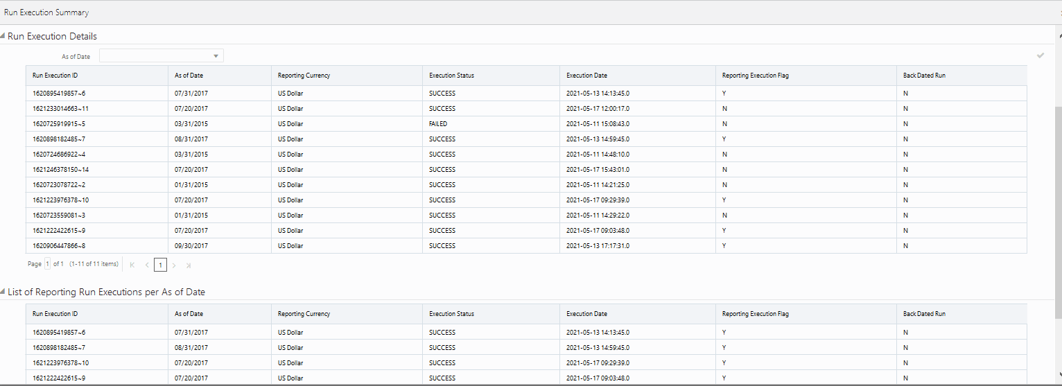

    This Run ID is now listed in the List of Reporting Run Execution per As-of-Date section.
    b. When you select a Run execution that has failed, the Reporting Execution Flag is disabled.
    The List of Reporting Run Execution per As-of-Date section displays the Run Execution Parameters, which are reported for execution.
