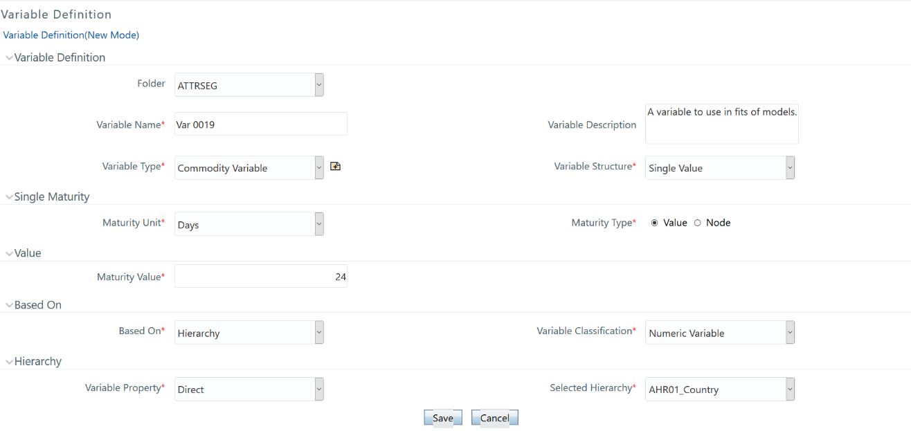

The Add Variable Definition page enables you to add a variable by filtering through the required parameters. The options available to filter the data vary depending on the variable type selected.
To add variable definition, follow these steps:
  1. Select the Add icon from the Variable Management toolbar.
    The Add button is disabled if you have selected any checkbox in the grid. The Variable Definition Add window is displayed.
    Figure 10-3 Variable Definition window
    This image displays the Variable Definition window.
  2. Enter the Variable details as described in the following table:

  3. If the variable is based on Hierarchy, follow these steps:
    • Select Variable Property as Direct or Dummy (variable in Binary form and used mainly in regression analysis). The Dummy option is available only if Variable Type is selected as General Macroeconomic Indicator or Idiosyncratic Variable.
    • Select the required Hierarchy from the Selected Hierarchy drop-down list.
      Hierarchy-based variables cannot be created on multi-level Business Intelligence hierarchies.
