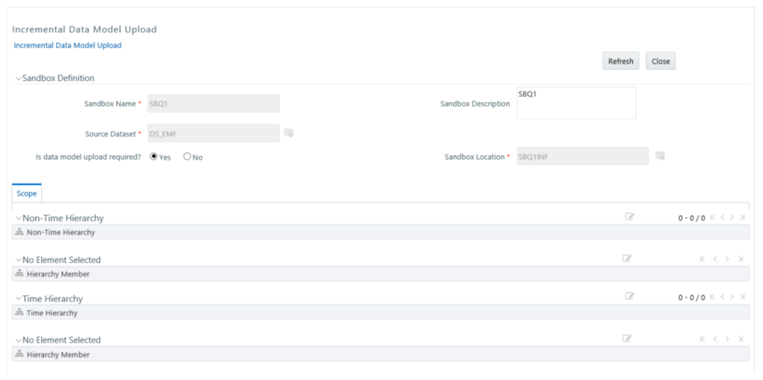

  2. Click Reset icon from the Sandbox Maintenance toolbar. The Incremental Data Model Upload window is displayed with the selected Sandbox definition details in View mode.
    Figure 6-5 Incremental Data Model Upload
    This image displays the Incremental Data Model Upload.
  3. Click Refresh. The incremental data model changes are fetched and updated.
  4. An information dialog is displayed confirming successful incremental data model upload. Click OK.
