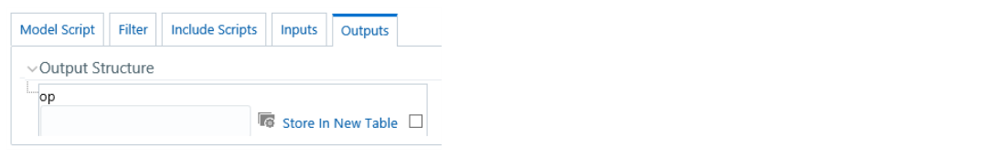

The Outputs tab allows you to store the output values computed during the model execution to a table in your atomic schema by mapping the output value to a variable, which you have defined through the Variables Definition window. This is supported only for record-level outputs. Additionally, you can create a new table to store the output if it is a dataframe, vector, or matrix.
You can view the Outputs tab only after declaring Output variables (## Output -->) in the model script.
Figure 9-6 Outputs tab
This image displays the Outputs tab.
  1. From the Outputs tab, click the icon corresponding to the declared output variable whose value you want to map to a variable. The Variable Browser window is displayed.
  2. Select the appropriate variable and click Ok.
  3. Select the checkbox corresponding to Store in New Table if you want to create a new table to store the output.
    New table name is <<Outputname>>_<<ModelID>>_<<Version Number>>. The combined length should not be more than 30. So ensure the Output name does not have any special characters.
