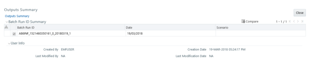

  2. Click the icon from the Model Outputs toolbar. The Output Summary window is displayed.
    Figure 9-10 Outputs Summary window
    This image displays the Outputs Summary window.
  3. Select the checkbox adjacent to a Batch Run ID to view the details or select multiple checkboxes to compare Batch Run IDs.
  4. Click the icon to view details or compare Batch Run ID(s). The View/Compare Sample window is displayed with the comparison details of the selected models

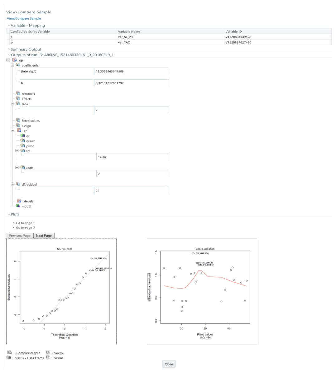

  5. Click the links to view/download the derived values stored as .csv files or plots saved as image files.
    Figure 9-11 Output window for R scripted models
    This image displays the Output window for R scripted models.
  6. Click the file name (.dat file) under the Summary Output pane to view the summary of outputs. This is displayed only for models based on Standard R Engine.
  7. Click the links in the Outputs pane to download or view the derived values in .csv files.
