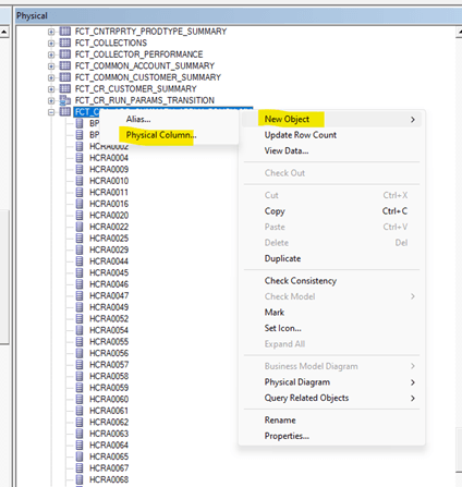

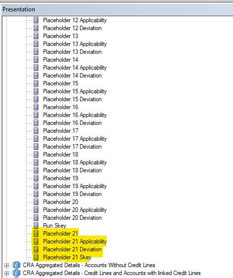

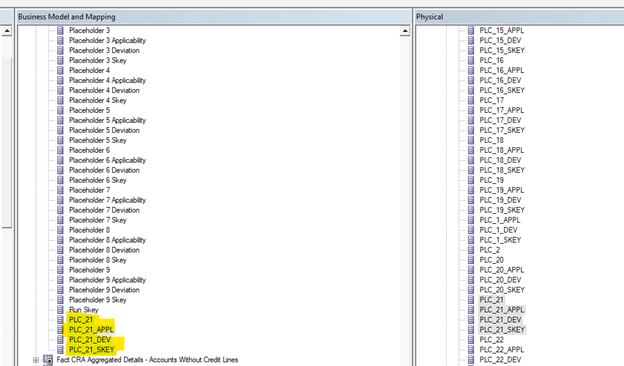

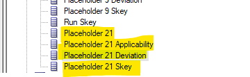

By default, 20 placeholders are enabled in the CRMBI.rpd. If you need more columns, remaining placeholder columns need to be imported in CRMBI.rpd from physical layer to BMM layer to Presentation layer.
