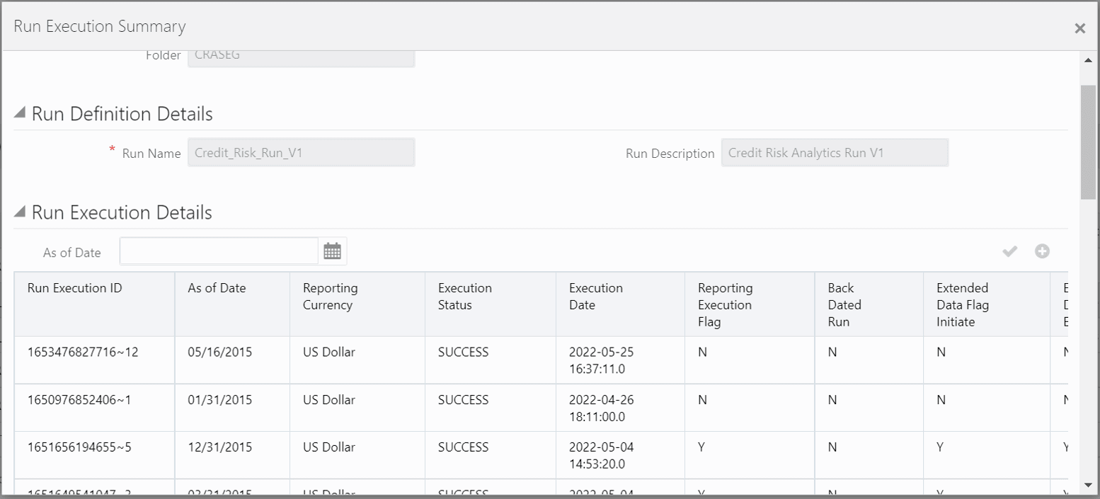

To view the summary of all the Run executions for a particular Run:
- Select the Run from the list of Runs in the Run Management
Summary window and click Run Execution
Summary.The Run Execution Summary window is displayed as follows:
Figure 6-3 Run Execution Summary
All the parameters entered as part of the Run Definition window are displayed in the Run Execution Summary window in an uneditable form. The Run Execution Details section displays the Run Execution Parameters specified for each execution.You can filter the Run executions by As-of-Date. - Select a successful Run Execution ID and click

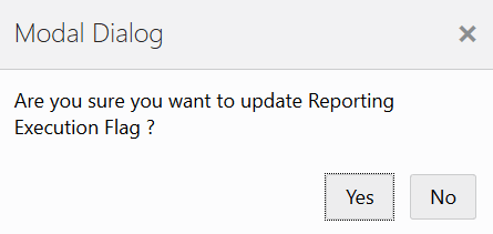

Reporting Execution Flag to report it for
execution.A confirmation message appears before updating the Reporting Flag.
Figure 6-4 Reporting Execution Flag
Figure 6-5 Modal Dialog

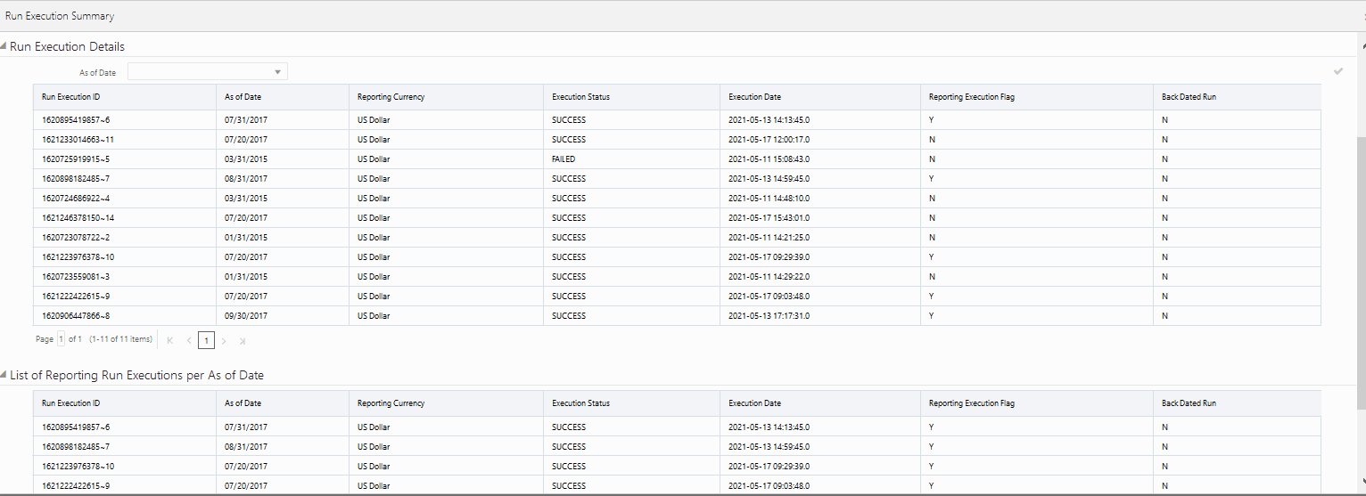

a. Click Yes.This Run ID is now listed in the List of Reporting Run Execution per As-of-Date section.b. When you select a Run execution that has failed, the Reporting Execution Flag is disabled.The List of Reporting Run Execution per As-of-Date section displays the Run Execution Parameters, which are reported for execution. - Select a successful Run Execution ID and click
Create Extended Data Flag to populate the data from
the executed Run in the executables based on the date of the selected Run.This feature enables you to select any one execution, out of the executions performed in a specific date. The selected Run is flagged as ready-to-execute. When you execute the <INFODOM>_CRA_BI_POPULATION batch, the data from the selected Run is populated in the respective tables, based on the date.
