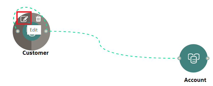

- On the Graph Summary page, select the graph pipeline you want to edit, click the Action icon, and select Edit.
- Hover over the graph pipeline and click Edit icon. The Node Detailspage is displayed.
Figure 6-121 Node Details page
- Perform the steps from 3 to 12 in the Creating a Node section.
