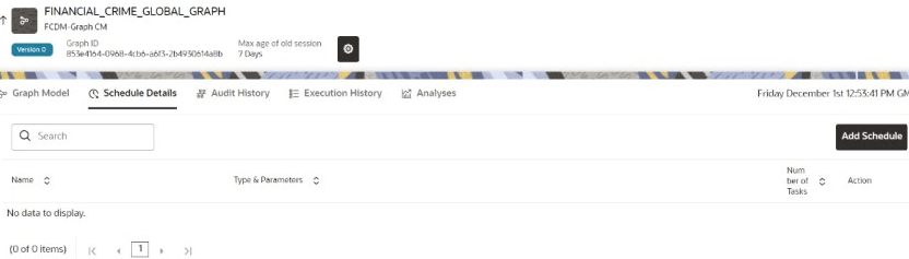

- Select the FINANCIAL_CRIME_GLOBAL_GRAPH, and then click Action icon.
- Select Edit to view the graph.
- Click Schedule Details tab.
- To edit the schedule of the graph, click Edit under Actions column.

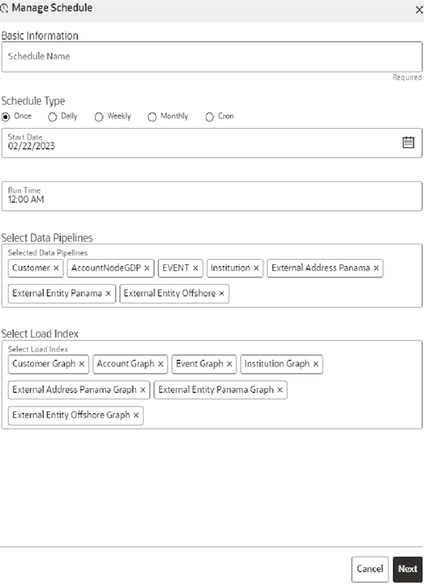

- Click Add Schedule to add a new schedule.
- On the Add Schedule screen, select all the tasks and
click Next.For more information on how to select/enter the parameters, see Schedule Details section.

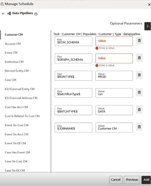

- Update the value for “$BD_SCHEMA” or “$ECM_SCHEMA”, “$GRAPH_SCHEMA” in the
selected task(s) where the value will be respective schema wallet alias. For
“$GRAPH_DS”, where the value will be datasource of the graph schema that is
attached to the Compliance Studio workspace.

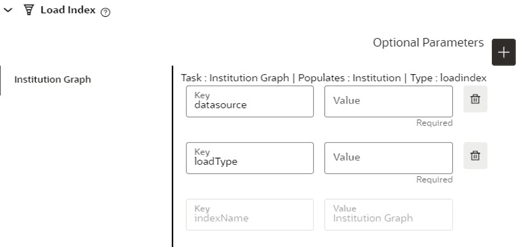

For BD graph, $BD_SCHEMA must be selected as the key value for the optional parameter. Similarly, for ECM graph, $ECM_SCHEMA must be selected as the key value for the optional parameter.In Load Index group,For the Pre-configured load index, respective Key fields will be displayed. You can configure the respective key-value in the Value field as required and specified in the following table.Table 9-14 Parameter for Load Index
Name Description Default Value datasource Datasource of the graph schema that is attached to the Compliance Studio workspace. - loadType Execution Load Type. Available types are full load and delta load. Note: In this release, only the delta load is supported.
DeltaLoad indexName Index name for the graph. Note: In this release, only the delta load is supported.
