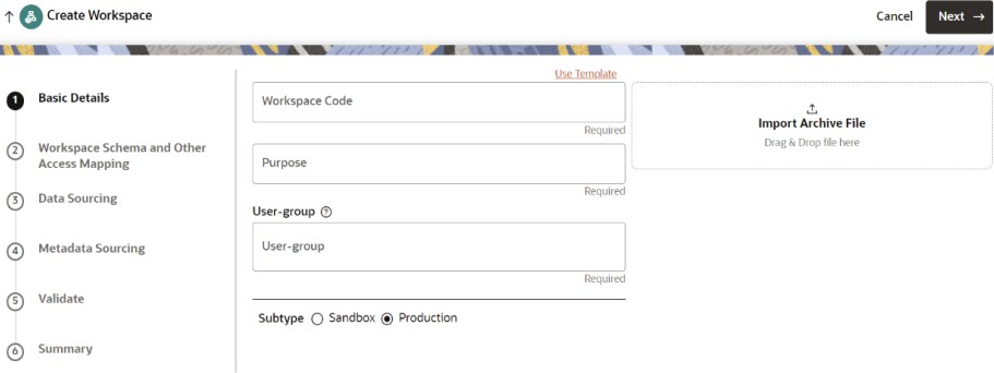

Basic Details
To create a basic details of the production workspace, follow these steps:
  1. Enter the Workspace Code and Purpose of the workspace.
  2. From the drop-down list, select the User-group.
  3. Select the subtype as Production.
  4. Click Next.

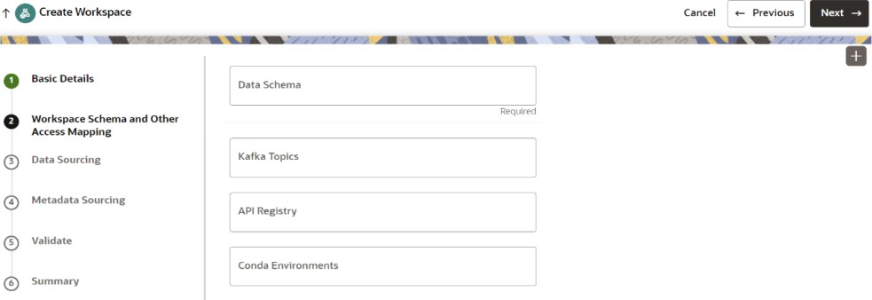

Workspace Schema
To create the workspace schema, follow these steps:
  1. Select the Data Schema as Sanction Atomic Schema.
    Leave the Kafka Topics and API Configurations fields as blank.
  2. Select the following Conda Environments:
    1. default_8.1.2.8.0
    2. ml4aml_8.1.2.8.0
  3. Click Next.

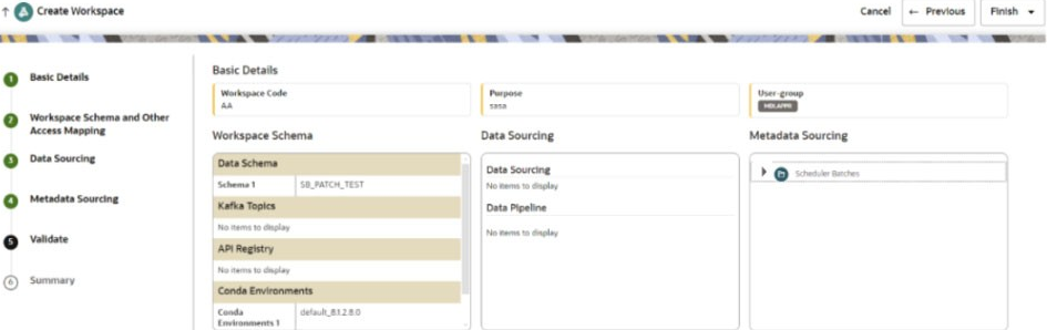

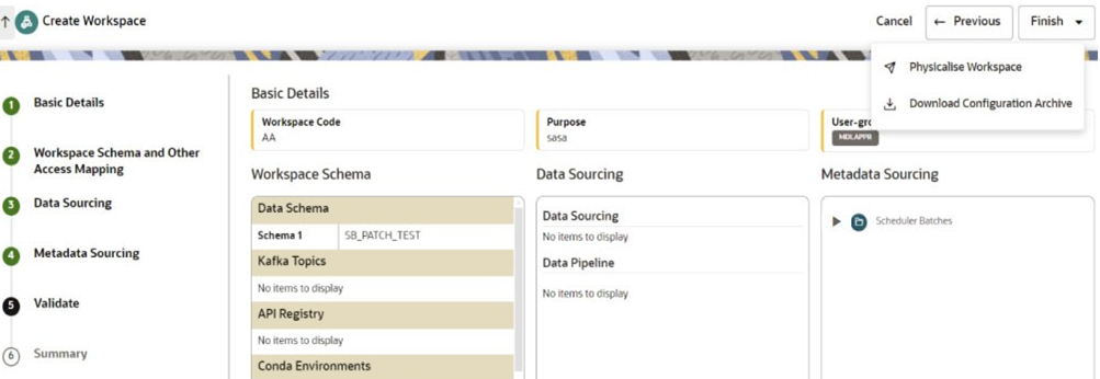

Validate Workspace
You can validate the Basic details, Workspace schema, Data Sourcing and Metadata sourcing before you physicalize the workspace.
To Physicalize the workspace, Click Finish and then select Physicalize Workspace.
Figure 5-46 Physicalize Workspace

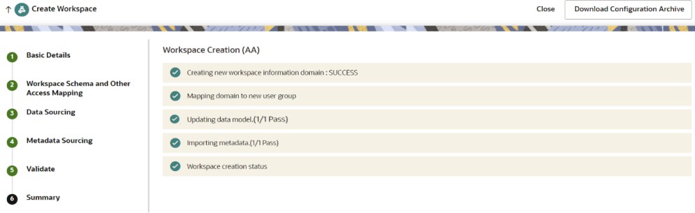

Summary
You can view summary of the created workspace.
