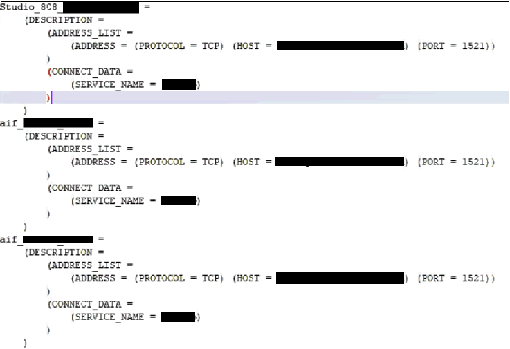

TNS_ADMIN_PATH Indicates the path of the tnsnames.ora file where an entry for the STUDIO_ALIAS_NAME is present. Enter the path of the tnsnames.ora file where an entry for the STUDIO_ALIAS_NAME is present.
For example: <COMPLIANCE_STUDIO_INSTALLATION_PATH>/wallet
STUDIO_ALIAS_NAME Indicates the Studio alias name. Enter Studio alias name.
For example: CS8127_XXX_XX_alias
Note: Enter the alias name that was created during wallet creation.
