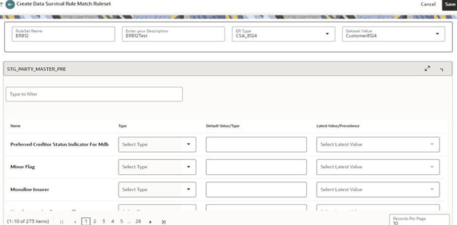

- On the Data Survival Rules page, click
Add. The page displays the attributes to create the
Rule.
You should not create multiple data survival rulesets for a particular ER Type. - Enter the field values as described in the following table.

Once you select the Dataset, the input tables are displayed. The list of tables will change based on the Dataset selection. Each table displayed can be expanded to allow you to select the survival function for each attribute if needed. - On the Create Data Survival Rule Match Ruleset page, perform the
following:
- Filter the records using the search filter (Type the filter)
- Sort the records
To sort the records, right-click on any of the columns and select Sort > Sort Ascending or Sort Descending for ascending and descending order, respectively. The records will be displayed according to sort order.
- Select the method types. See the following step for method type details.
