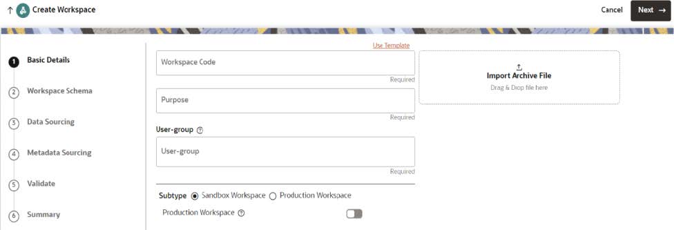

Basic Details
To create basic details of the sandbox workspace, follow these steps:
  1. Provide the requested details for Workspace Code and Purpose.
  2. From the drop-down list, select the User-group.
  3. Select the subtype as Sandbox Workspace.
  4. Enable the Production Workspace button.
  5. From the drop-down list, select the Sanction Production Workspace that was created in Sanctions Event Scoring Production Workspace.
  6. Click Next.
    Figure 5-54 Basic Details

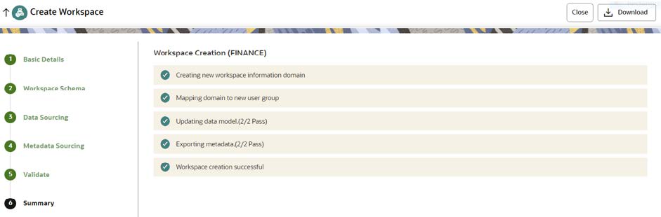

Summary
You can view summary of the created workspace.
Figure 5-59 Summary of created workspace
