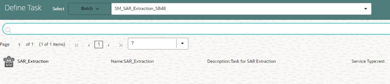

The batch contains a single task named SAR_Extraction.
Figure 5-46 Define Task for SAR_Extraction
Task: SAR_Extraction, Task Parameters
  • Objective folder for this task:
    Home / Model Pipelines / ML4AML / Scenario Model / Batch / SAR Extraction
  • Do not change any parameter, except Optional Parameters.

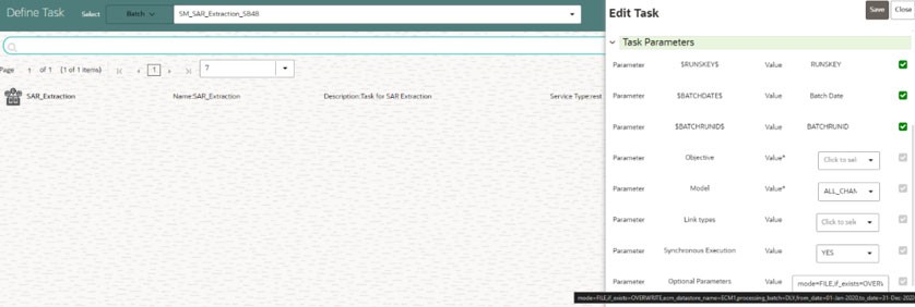

  • Optional Parameters:
    • mode: Extraction Mode to be used. This parameter is case-sensitive, and the option is either FILE or ECM.
    • if_exists: This parameter is used to set the behavior of data insertion. This parameter is case-sensitive, and the option is either OVERWRITE or APPEND.
      • OVERWRITE: Overwrites the rows where ENTITY_ID, ALERT_DATE, and LABELLED_SCENARIO are matched and inserts the rest of the rows.
      • APPEND: Ignores the rows where ENTITY_ID, ALERT_DATE, and LABELLED_SCENARIO are matched and inserts the rest of the rows.
    • ecm_datastore_name: Data Store created in the Compliance Studio UI for ECM atomic schema from where we need to extract the investigated labels.
    • processing_batch: Value for v_data_origin column from the fcc_events table in ECM.
    • from_date: Value for d_mis_date from the fcc_events table in ECM. The format should be DD-Mon-YYYY.
    • to_date: Value for d_mis_date from fcc_events table in ECM. The format should be DD-Mon- YYYY.
  • Example: mode=ECM,if_exists=OVERWRITE,ecm_datastore_name=SM_ECM, processing_batch=DLY,from_date=01-Nov-2015,to_date=30-Dec-2015
  • Edit Task Parameters & Save.

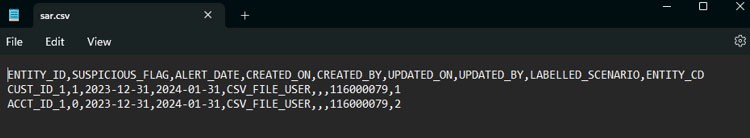

A sample CSV is shipped with Compliance Studio named sar.csv in the <COMPLIANCE_STUDIO_INSTALLATION_PATH>/deployed/ml4aml/demodata/sar.csv directory.
This sample CSV is shipped with headers that resemble the structure of the AIF_INVESTIGATED_ENTITY table and two sample rows showing the format of each column.
Figure 5-48 Snapshot of sar.csv
When running the SM_SAR_Extraction batch with mode = FILE, the user should ensure that the following columns are available with the required values in the CSV files:
  • ENTITY_ID: Customer ID or Account ID.
  • SUSPICIOUS_FLAG: This flag has two options and they are 1 (Suspicious) and 0 (Nonsuspicious).
  • ALERT_DATE: SAR/EVENT generation date. The format should be YYYY-MM-DD.
  • CREATED_ON: CSV file creation date. The format should be YYYY-MM-DD.
  • CREATED_BY: CSV file created by
  • UPDATED_ON: CSV file updated date. The format should be YYYY-MM-DD.
  • UPDATED_BY: CSV file updated by
  • LABELLED_SCENARIO: Scenario ID corresponding to the entity_id and alert_date.
  • ENTITY_CD: This parameter has the following options:
    • CUSTOMER
    • ACCOUNT
    • EXTERNAL ENTITY
    • CLIENT_BANK
The batch will read this file from its default location and load data to AIF_INVESTIGATED_ENTITY based on the if_exists condition.
In the CSV file, the user is expected to populate Non-Null data for all the columns except UPDATED_ON and UPDATED_BY.
