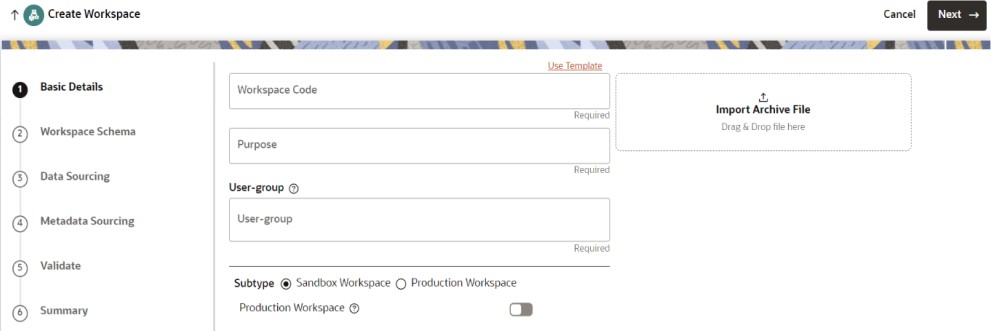

Basic Details
To create a basic details of the workspace, follow these steps:
  1. Enter the Workspace Code and Purpose of the workspace.
  2. Select the User-group from the drop-down list.
  3. Select the subtype as Sandbox Workspace.
    By default, the Production Workspace is disabled.
  4. Click Next.

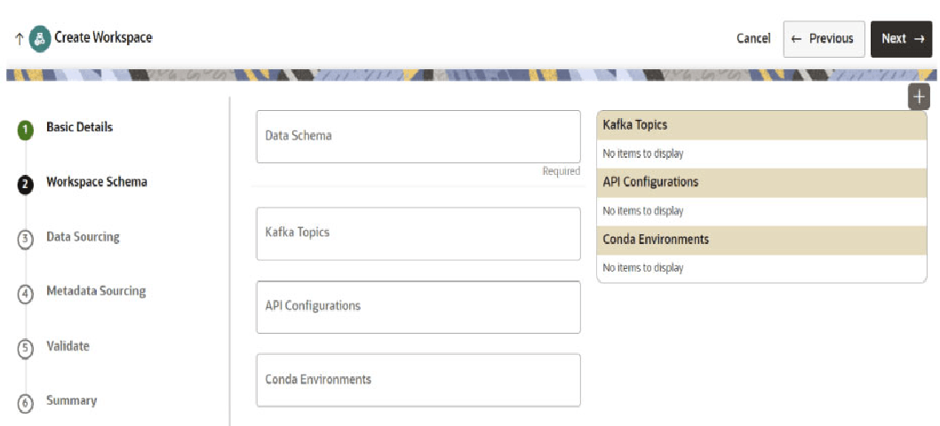

Workspace Schema
To create the workspace schema, follow these steps:
  1. Select the Data Schema as ASC BD Schema.
    Leave Kafka Topics and API Configuration fields as blank.
    For more information about Creating Data Schema creation, see How to Create Data Store.
  2. Select the following Conda Environments:
    1. default_<CS Version>
    2. ml4aml_<CS Version>
  3. Click Next.

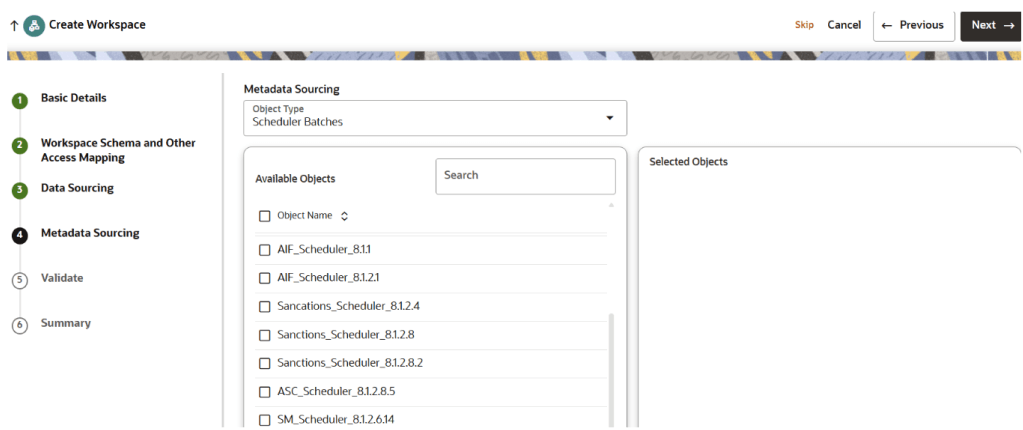

Metadata Sourcing
To source metadata, follow these steps:
  1. From the Object Type drop-down list, select Scheduler Batches.
  2. In the Available Objects, select the ASC_Scheduler_8.1.2.8.5.
  3. Click Next.

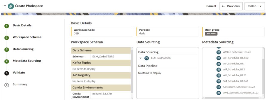

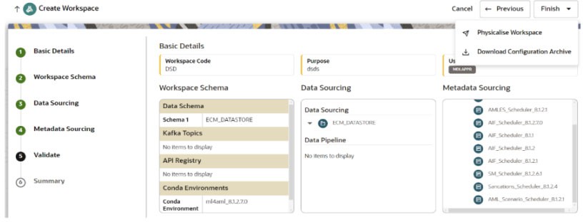

Validate Workspace
  1. Click Finish and then select Physicalise Workspace.
    Figure 5-5 Physicalise Workspace

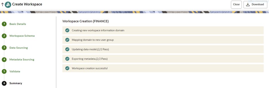

Summary
You can view summary of the created workspace.
