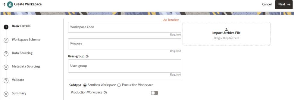

Basic Details
To create basic details of the sandbox workspace, follow these steps:
  1. Provide the requested details for Workspace Code and Purpose.
  2. From the drop-down list, select the User-group.
  3. Select the subtype as Sandbox Workspace.
  4. Enable the Production Workspace button.
  5. From the drop-down list, select the Sanction Production Workspace that was created in Sanctions Event Scoring Production Workspace.
  6. Click Next.
    Figure 5-54 Basic Details

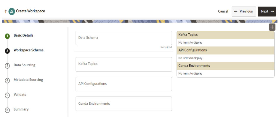

Workspace Schema
To create the workspace schema, follow these steps:
  1. Select the newly created data store as Data Schema.
    Leave the Kafka Topics and API Configurations fields as blank.
    For more information about creating Data Store, see How to Create Data Store.
  2. Select the following Conda Environments:
    1. default_8.1.2.9.4
    2. ml4aml_8.1.2.9.4
  3. Click Next.
    Figure 5-55 Workspace Schema

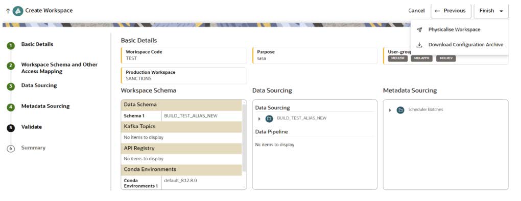

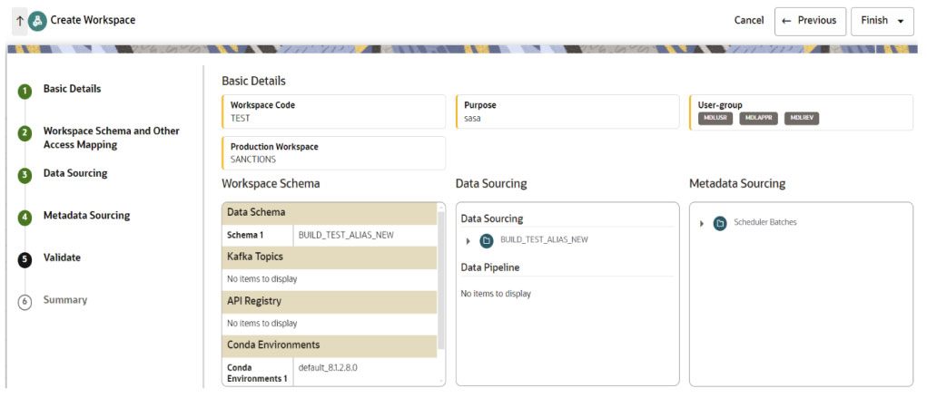

Validate Workspace
You can validate the Basic details, Workspace schema, Data Sourcing and Metadata sourcing before you physicalize the workspace.
Figure 5-57 Validate Workspace
Validate Workspace
To Physicalise the workspace, Click Finish and then select Physicalise Workspace.
Figure 5-58 Physicalize Workspace

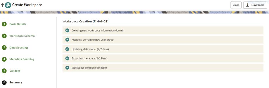

Summary
You can view summary of the created workspace.
Figure 5-59 Summary of created workspace
