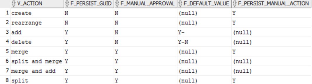

Properties for Global Party ID Persistence
When global parties change (parties are added or removed), the system can be configured to either create a new global party id or to keep one of the existing ids depending on need to preserve global party in downstream systems.
The fcc_er_guid_persist_config table contains the configuration for Global Party ID Persistence.
The following table describes column/flag deatils in the FCC_ER_GUID_PERSIST_CONFIG.
Table 4-2 FCC_ER_GUID_PERSIST_CONFIG
Column Name/Flag Description

F_PERSIST_GUID This flag represents whether the Global Party ID should be persisted or not whenever it undergoes change in an ER batch. The valid values are Y and N. The GUID is persisted if the flag is set to Y for the particular action.
Note: This flag is not applicable for create and rearrange actions as these are manual actions.
F_DEFAULT_VALUE This flag represents the default value that will override the values present in the F_PERSIST_GUID and F_MANUAL_APPROVAL flags.
F_PERSIST_MANUAL_ACTI ON This flag represents whether the Global Party ID can be persisted or not through manual action. The valid values are Y and N. The GUID is persisted if the flag is set to Y for the particular action. If the flag is set to N, then new Global Party ID will be created.
Note: This flag is applicable only for Merge, Split, Create and Rearrange actions.
  • Only the flags in F_PERSIST_GUID and F_MANUAL_APPROVAL should be modified. F_DEFAULT_VALUE should not be modified for any action.
  • For add and delete actions, the GUID always persists irrespective of the user input in the F_PERSIST_GUID flag.
  • For delete action, manual approval is not required irrespective of the user input provided in the F_MANUAL_APPROVAL flag.
  • If F_PERSIST_GUID and F_MANUAL_APPROVAL flags for the split action are set to Y and Y respectively, then flags for split and merge action will also be considered as Y and Y regardless of the user input. Similarly, If F_PERSIST_GUID and F_MANUAL_APPROVAL flags for the split and merge action are set to Y and Y respectively, then flags for the split action will also be considered as Y and Y regardless of the user input.
The following image shows default configuration of the fcc_er_guid_persist_config table.
Figure 4-10 fcc_er_guid_persist_config table
