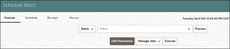

  1. Log in to the Compliance Studio UI.
  2. Select the appropriate Workspace.
  3. Click Orchestration menu and then select Schedule Batch. The Schedule Batch page is displayed.
  4. Select the appropriate Batch Scheduler.

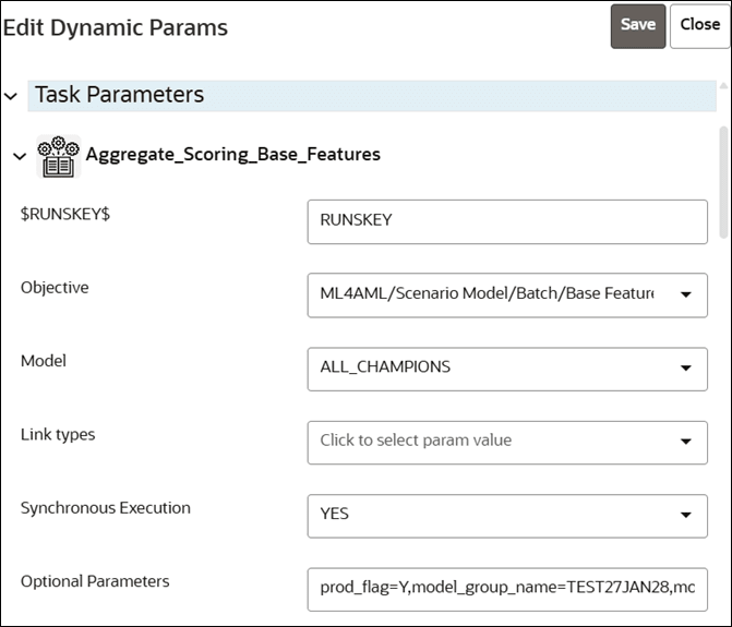

  5. Click Edit Parameters. The Edit Dynamic Params window is displayed.
    Figure A-33 Edit Dynamic Params
  6. In the Task Parameters, select Model from the drop-down list. The options are:
    • CHAMPION
    • ALL_CHAMPIONS
    • <Model belongs to Published/Previous Version>
    The CHAMPION and ALL_CHAMPIONS indicates the latest upgraded version.
    If the model is built on a previous version of Compliance Studio, select the corresponding model version to execute the batch.
  7. Click Save.
  8. Click Execute to execute the batch.
    This is also applicable when executing batches via an external scheduler.
