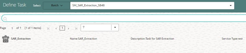

The batch contains a single task named SAR_Extraction.
Figure 5-46 Define Task for SAR_Extraction
Task: SAR_Extraction, Task Parameters

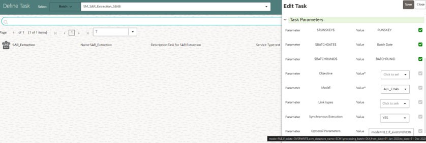

  • Example: mode=ECM,if_exists=OVERWRITE,ecm_datastore_name=SM_ECM, processing_batch=DLY,from_date=01-Nov-2015,to_date=30-Dec-2015
  • Edit Task Parameters & Save.
    Figure 5-47 Edit Task for SAR_Extraction

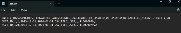

A sample CSV is shipped with Compliance Studio named sar.csv in the <COMPLIANCE_STUDIO_INSTALLATION_PATH>/deployed/ml4aml/demodata/sar.csv directory.
This sample CSV is shipped with headers that resemble the structure of the AIF_INVESTIGATED_ENTITY table and two sample rows showing the format of each column.
Figure 5-48 Snapshot of sar.csv
