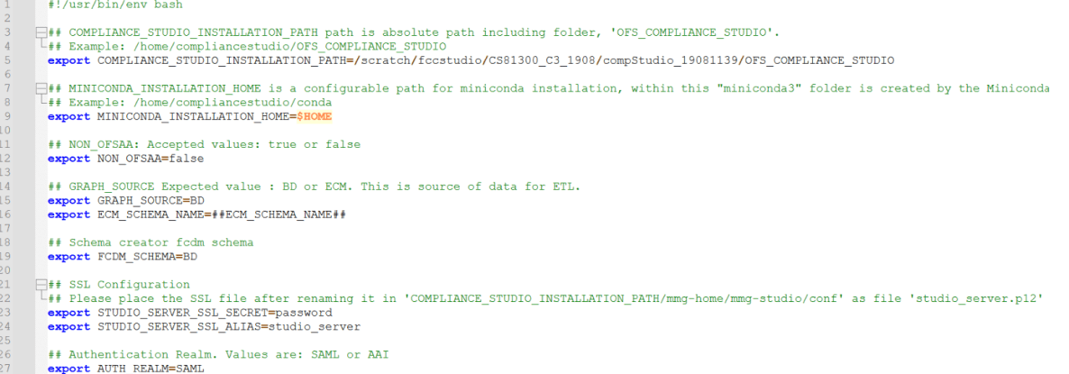

    A sample config.sh file is shown below for reference.
    Figure 2-5 Snapshot of config.sh file
    • You must manually set the parameter value in the config.sh file. If a value is not applicable, enter NA and ensure that the value is not entered as NULL.
    • If the parameter STUDIO_DB_SERVICE_NAME has been filled, the parameter STUDIO_DB_SID should be left blank, and vice versa.
    • If the parameter ATOMIC_DB_SERVICE_NAME has been filled, the parameter ATOMIC_DB_SID should be left blank, and vice versa.
