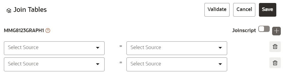

You can join Tables either using drop-down or using the Joinscript option.
Using Drop-down
Select the Column name of Table from the drop-down list. You can use multiple join conditions by using icon.
In the current release, only INNER JOIN is present.

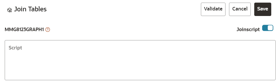

Using Script
  1. To use script, enable Join Script option.
    The Join Tables window is displayed to add scripts.
    Figure 6-12 Join Tables window
    This image displays the Join Tables window.

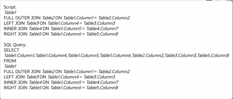

    You must provide the script in below format:
    Figure 6-13 Script
    This image displays the Script.
  2. Click Validate to check the Join conditions.
  3. Click Save.
