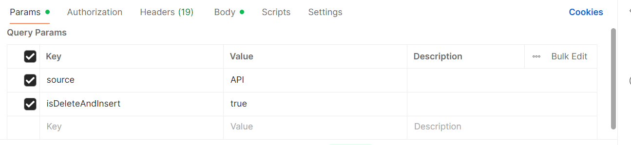

  6. Set the method to POST and enter the following URL: https://{{host_url}}/{{context_namespace}} /watchlist-service/privatewatchlist/importdata/{username}?source=API&isDeleteAndInsert=true
    Figure 5-1 Query Params
    Query Params
    Behavior of the isDeleteAndInsert Query Parameter:
    • When isDeleteAndInsert=true:
      • Existing watchlist records are updated.
      • New records are added.
      • Records that are no longer present in the request are deleted from the watchlist.
    • When is DeleteAndInsert=false or not provided:

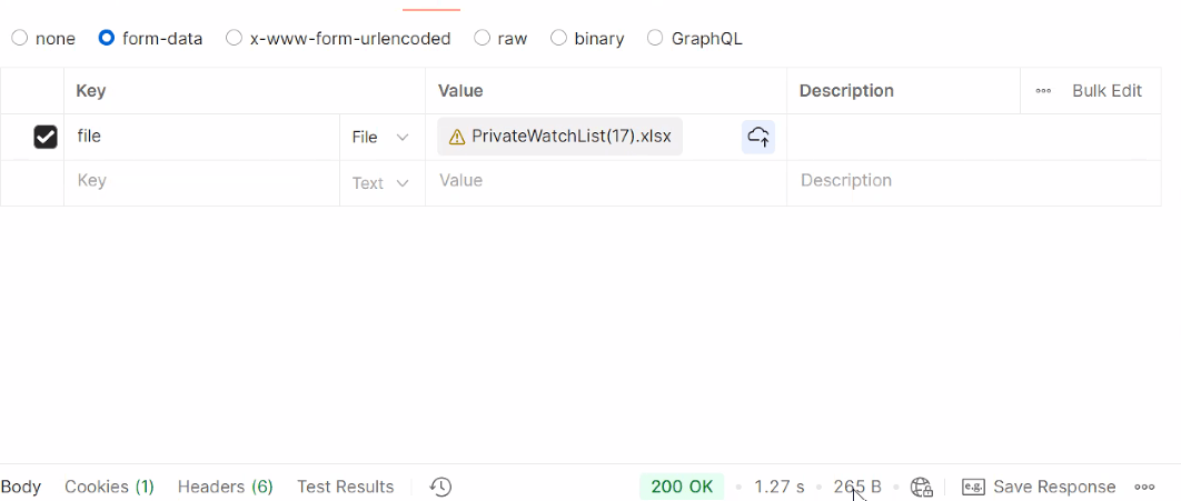

  7. Click the Body tab, select form-data. The form-data screen appears.
    Figure 5-2 The form-data screen
    1. In the first row under the Key column, enter file.
    2. Select the value type as File from the drop-down list.
    3. In the Value column, select the type as File from the drop-down and upload the updated Private Watchlist file.
      This setup allows the file to be transmitted as form-data as required by the API.
  8. Click Send.
    Once the request is submitted, you will receive a response confirming the status of the upload.
