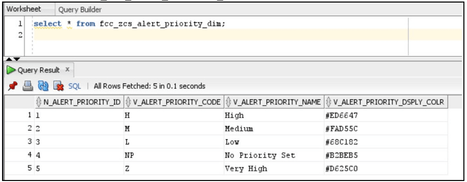

- Access the Atomic Schema and access the FCC_ZCS_ALERT_PRIORITY_DIM table.
- Change the following parameter value:
N_ALERT_PRIORITY_IDV_ALERT_PRIORITY_CODEV_ALERT_PRIORITY_NAMEV_ALERT_PRIORITY_DSPLY_COLR
Figure 3-5 FCC_ZCS_Alert Priority_DIM_table
MERGE INTO FCC_ZCS_ALERT_PRIORITY_DIM T USING ( SELECT '4' N_ALERT_PRIORITY_ID, 'B' V_ALERT_PRIORITY_CODE, 'Lower Medium' V_ALERT_PRIORITY_NAME, '#25C0D6' V_ALERT_PRIORITY_DSPLY_COLR FROM DUAL) S ON ( T.N_ALERT_PRIORITY_ID = S.N_ALERT_PRIORITY_ID ) WHEN MATCHED THEN UPDATE SET T.V_ALERT_PRIORITY_CODE = S.V_ALERT_PRIORITY_CODE, T.V_ALERT_PRIORITY_NAME = S.V_ALERT_PRIORITY_NAME, T.V_ALERT_PRIORITY_DSPLY_COLR = S.V_ALERT_PRIORITY_DSPLY_COLR WHEN NOT MATCHED THEN INSERT (N_ALERT_PRIORITY_ID,V_ALERT_PRIORITY_CODE,V_ALERT_PRIORITY_NAME,V_ALERT _PRIORITY_DSPLY_COLR) VALUES (S.N_ALERT_PRIORITY_ID,S.V_ALERT_PRIORITY_CODE,S.V_ALERT_PRIORITY_NAME,S .V_ALERT_PRIORITY_DSPLY_COLR) / - Access the FCC_ZCS_ALERT_PRIORITY_TL table.

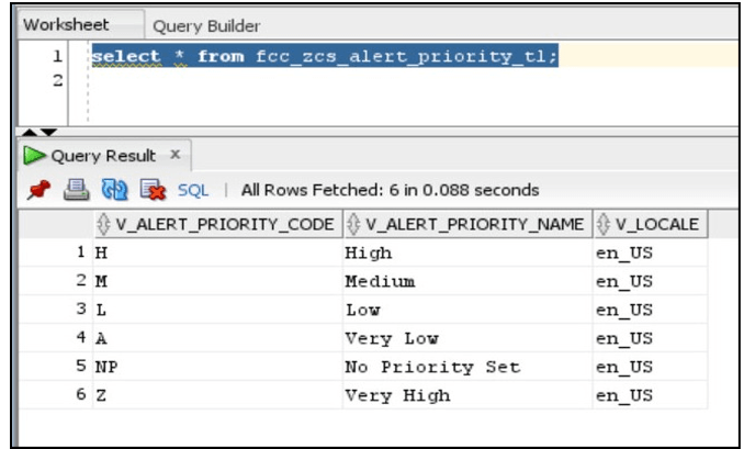

- V_ALERT_PRIORITY_CODE
- V_ALERT_PRIORITY_NAME
- V_LOCALE
TheFCC_ZCS_ALERT_PRIORITY_DIMtable andFCC_ZCS_ALERT_PRIORITY_TLtable must have the same parameter value entry.
Figure 3-6 FCC_ZCS_Alert_Priority_TL
MERGE INTO FCC_ZCS_ALERT_PRIORITY_TL T USING ( SELECT 'B' V_ALERT_PRIORITY_CODE, 'Lower Medium' V_ALERT_PRIORITY_NAME, 'en_US' V_LOCALE FROM DUAL) S ON ( ) WHEN MATCHED THEN UPDATE SET T.V_ALERT_PRIORITY_CODE = S.V_ALERT_PRIORITY_CODE, T.V_ALERT_PRIORITY_NAME = S.V_ALERT_PRIORITY_NAME, T.V_LOCALE = S.V_LOCALE WHEN NOT MATCHED THEN INSERT (V_ALERT_PRIORITY_CODE,V_ALERT_PRIORITY_NAME,V_LOCALE) VALUES (S.V_ALERT_PRIORITY_CODE,S.V_ALERT_PRIORITY_NAME,S.V_LOCALE) /

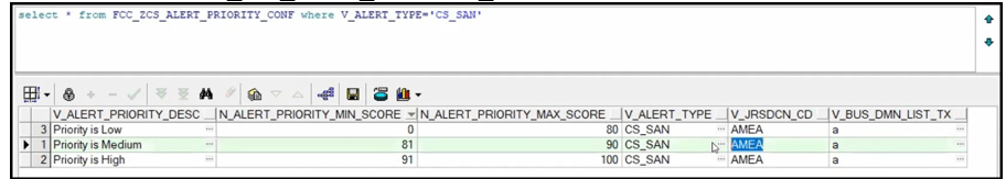

The priority for the new alerts are decided based on the score configured for the priority.
To define the priority and color code for the new alerts created based on the score, follow the below steps:
- Access the Atomic Schema and access the FCC_ZCS_ALERT_PRIORITY_CONF table.
- N_ALERT_PRIORITY_SEQ
- N_ALERT_PRIORITY_MIN_SCORE
- N_ALERT_PRIORITY_MAX_SCORE
- V_ALERT_TYPE_CODE
Figure 3-7 FCC_ZCS_Alert_Priority_Conf_table
MERGE INTO FCC_ZCS_ALERT_PRIORITY_CONF T USING (
SELECT '37' N_ALERT_PRIORITY_SEQ, 'B' V_ALERT_PRIORITY_CODE, '81'
N_ALERT_PRIORITY_MIN_SCORE, '85' N_ALERT_PRIORITY_MAX_SCORE, 'CS_RT_SAN'
V_ALERT_TYPE_CODE, 'AMEA' V_JRSDCN_CD, 'a' V_BUS_DMN_LIST_TX FROM DUAL)
