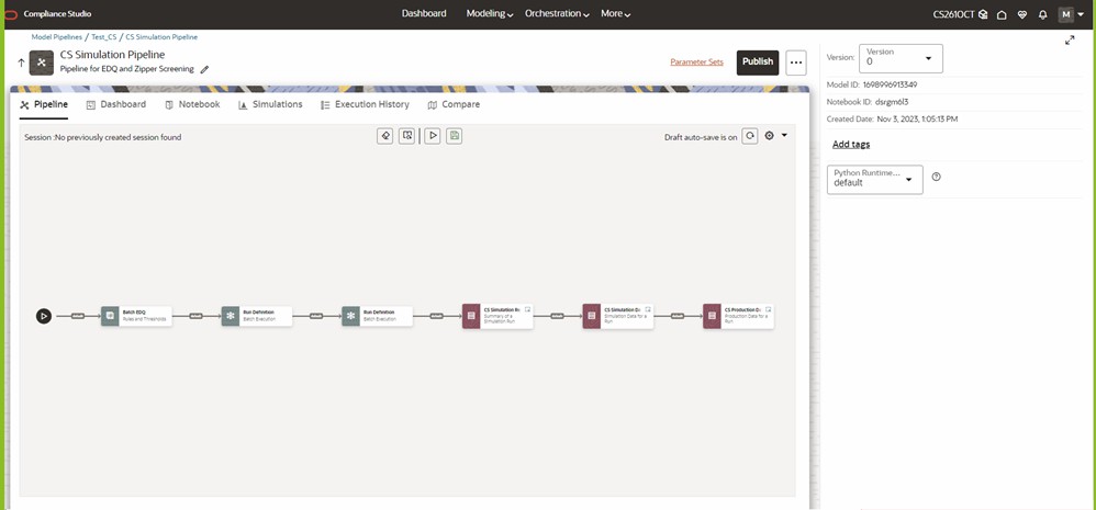

Figure 9-22 CS Simulation Pipeline

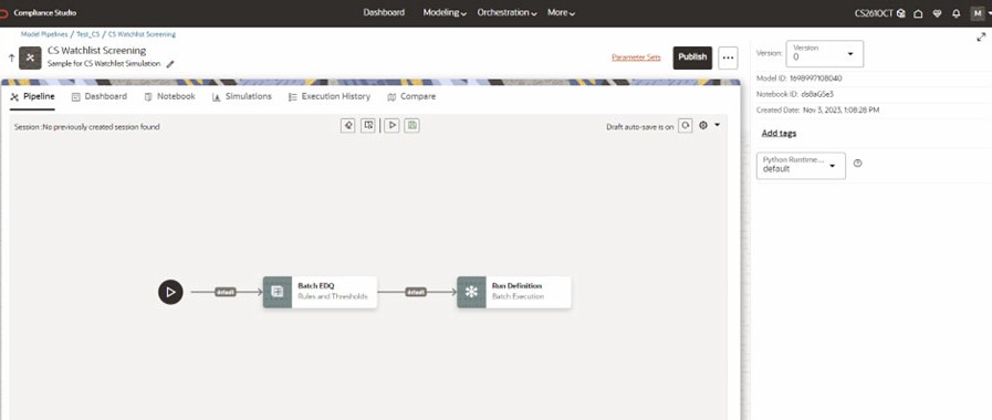

Figure 9-23 CS Watchlist Screening Pipeline

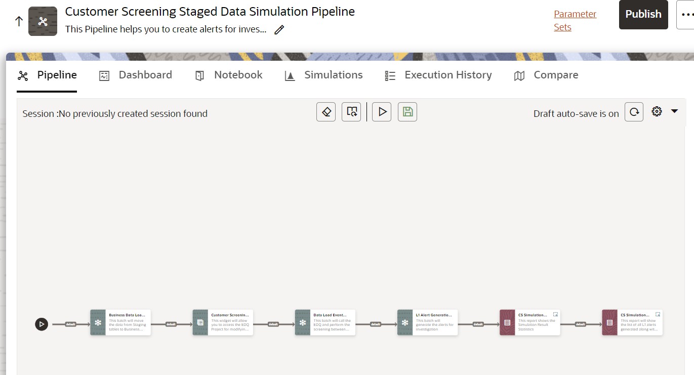

Figure 9-24 Customer Screening Staged Data Simulation Pipeline

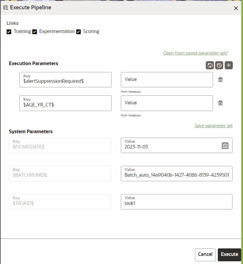

To execute the pipeline follow the subsequent steps:
- Click execute
. Execute Pipeline window is displayed.
Figure 9-25 Execute Pipeline
- Click Open from saved Parameter set? to import the template.
- If your not importing the template enter Enter the execution Key and Value
manually.
Select the flow, which you want to execute Scoring, Training, and Experimentation. It displays all the keys defined for all the paragraphs in the notebook with a placeholder for providing the values. - You can add new parameters using Add
If the parameter is not defined in the notebook, it will not be used for the execution. In case of multi select, if there are common parameters among the chosen scenarios, it will take the value based on the order of selection. that is first chosen scenario parameter will be taken. - But if open from saved scenarios again (not on single go), then already added will get replaced by the newly added (same as what existed)
- Execution is performed based on selected link types. It filters out
all the not required/unused parameters. And, all the unused parameters for the
current execution are displayed with a warning
. To view the only required parameters, click Show only
required link.
- Click Reset
to reset the entered data.
- Click Delete
to delete the entered Key and Value.
- Click Execute to initiate the execution. The
widgets in pipelines are executed sequentially and you can see
icon on each widget for a successful execution. For individual widget
execution details click the widget and click View
Details.
