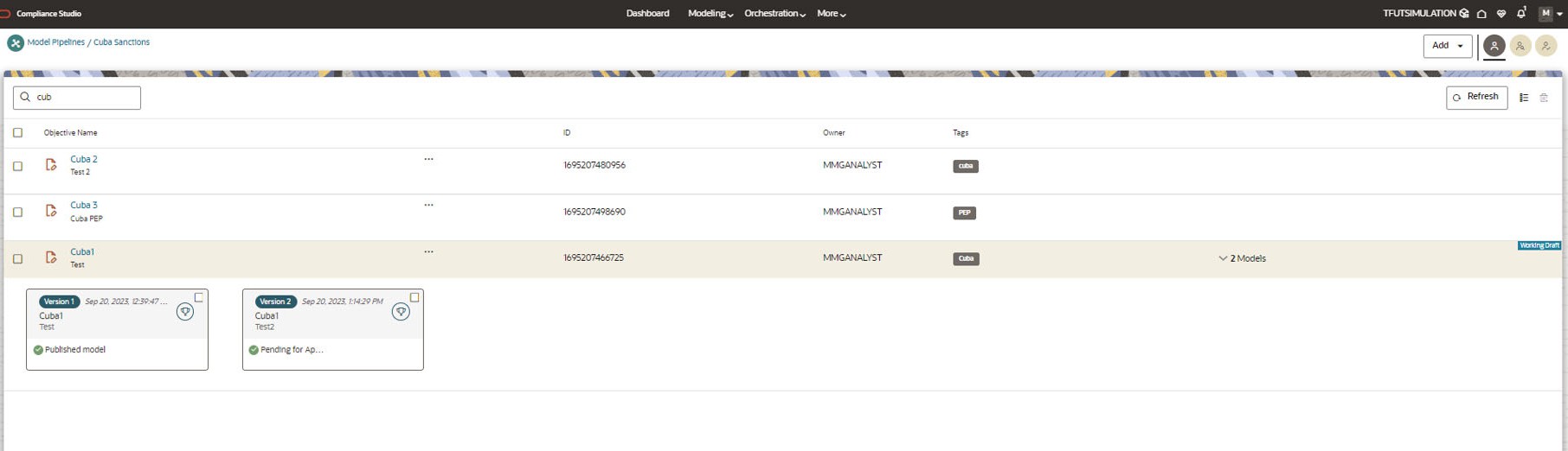

- Navigate to Model Pipeline page.
- Click Models in-line with the Object Name. published
models are displayed.
Figure 9-34 Published Model
The published models are then deployed in production to be consumed by users. The iterations of comparison between various models lead to the elimination of undesired models and the filter of a few robust ones that can be considered for deployment in production. Modelers then use their better judgment to consolidate their choice and fix on one model - the champion model. The champion model is also called the scoring model or the actual model in this document.
