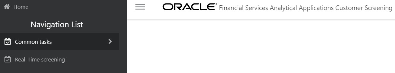

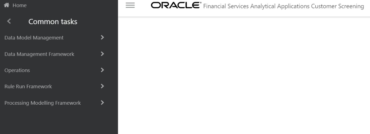

- Click the hamburger
icon to view the Application Navigation List.
Figure D-3 Application Navigation List
- From the Application Navigation List, select Common Tasks, then select Rule Run Framework, and then select Run. The Run page appears.

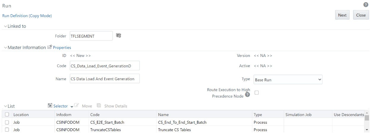

- In the Run page, follow these steps to create a duplicate
batch:
- Select the
CS_Data_Load_Event_Generation
run and click Copy. The Run page opens in copy mode.Note:
You must select the segment folder for the Sanctions pack in the Folder field to proceed.Figure D-4 Run Page in Copy Mode
- Enter a new run code or alter the existing value in the
Code field. For example, code can be
CS_Data_Load_Event_GenerationD
. - Enter a new run name or alter the existing value in the Code field. For
example, name can be
CS Data Load And Event Generation
.Note:
The run name and run code values can be the same. - Click Next to go to the next page and confirm the name.
- Click Save.

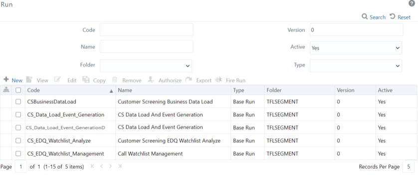

After you click Save, the new run name appears in the Run page.
Figure D-5 New Run Name in Run Page

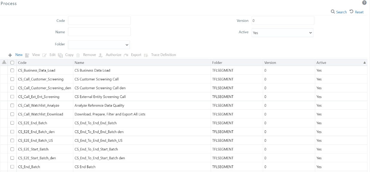

- Duplicate the
CS_E2E_Start_Batch, CS_Call_Customer_Screening
, andCS_E2E_End_Batch
processes in the Process page.Figure D-6 Process Page

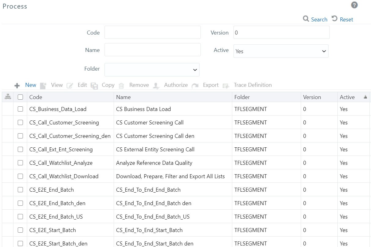

- To duplicate each process, follow these steps:
- For the
CS_E2E_Start_Batch
process:- In the Process page, select
CS_E2E_Start_Batch
and click Copy. The Process page opens in copy mode.Note:
You must select the segment folder for the Sanctions pack in the Folder field to proceed. - Enter a new process code in the Code
field and a new process name in the Name
field. You can also alter the existing process code or name. For
example,
CS_E2E_Start_Batch_den
. - Click Save.
- For the
and click Copy. The Process page opens in copy mode. - Enter a new process code in the Code
example,
CS_Call_Customer_Screening_den
. - Click Save.
- For the
CS_E2E_End_Batch
CS_E2E_End_Batch
example,
CS_E2E_End_Batch_den
. - Click Save.
After you click Save, the new process names appear in the Process page.Figure D-9 New Process Names in Process Page

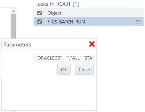

- Change the parameter for the
process. To do this, follow these steps:- Select the duplicated process created in the earlier step and click Edit. The Process page opens in edit mode.
- Click Component. The Component Selector window appears.
- Click the drop-down list in line with the
F_CS_BATCH_RUN task. The
Parameters window appears.
Figure D-10 Parameter for the CS_E2E_Start_Batch Process
- Change the
ORACLECS
parameter to the applicable data origin or processing name.

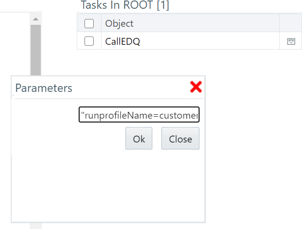

- To change the parameters for the
process, follow these steps:- Select the duplicated process created in the earlier step and click Edit. The Process page opens in edit mode.
- Select the drop-down list in line with the
CallEDQ task. The
Parameters window appears with the following
values:
"runprofileName=customer-screening1.properties","RunLabel=customerscreening"," JobName=MAIN","ProjectName=Customer- Screening","edqServerName=SERVER_2","condition=and AGE_YR_CT>20 and BIRTH_DT <= @$~20 June 1972@$~"
Figure D-12 Parameters for the CS_Call_Customer_Screening_den Process
- Change the following parameters:
- Run profile name
Example:
" - EDQ server name. If you do not change the server name, it is
replaced with the server name in the
cs_appln_params
table.Example:

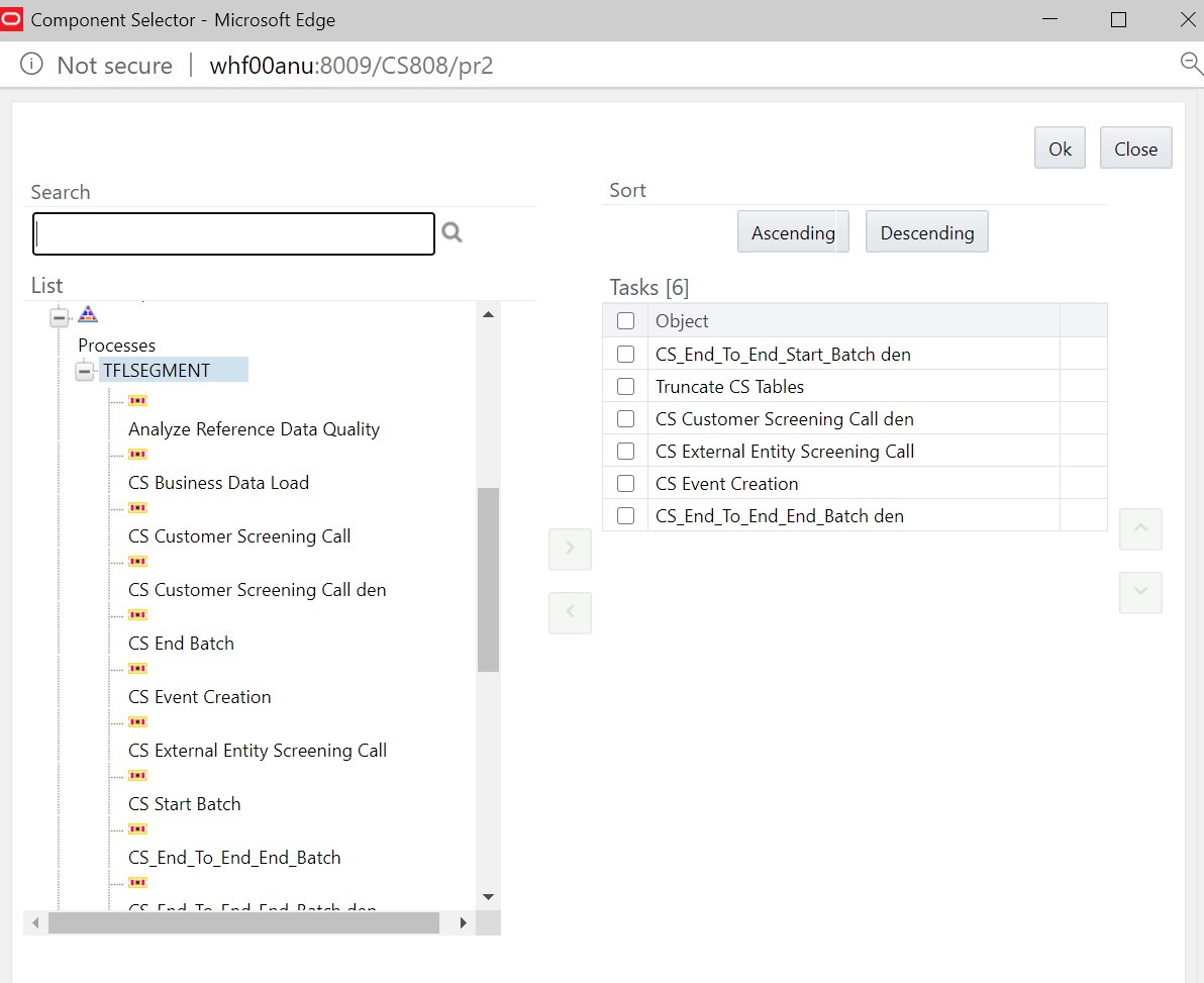

- Replace the new batches in the Run page. To do this,
follow these steps:
- Select
CS_Data_L_Event_Generation_Den
and click Edit. The Run page opens in edit mode. - Click the Selector drop-down list and select
Job. The Component Selector
window appears.
Figure D-13 Parameters for the CS_Call_Customer_Screening_den Process
- In the List hierarchy window, expand the Transformation Rules node.
- Expand the Processes node and then the TFLSEGMENT node.
- In the Tasks table, select the original
processes, which are
CS_End_To_End_Start_Batch, CS Customer Screening Call
, andCS_End_To_End_End_Batch
. These processes must be selected one at a time. - Click Move
. The selected batches are displayed in the TFLSEGMENT node.
- In the List table, select the new processes,
which are
CS_End_To_End_Start_Batch_den, CS Customer Screening Call den
, andCS_End_To_End_End_Batch_den
. - Click Remove
. The selected batches are displayed in the Tasks table.
- Click OK.
