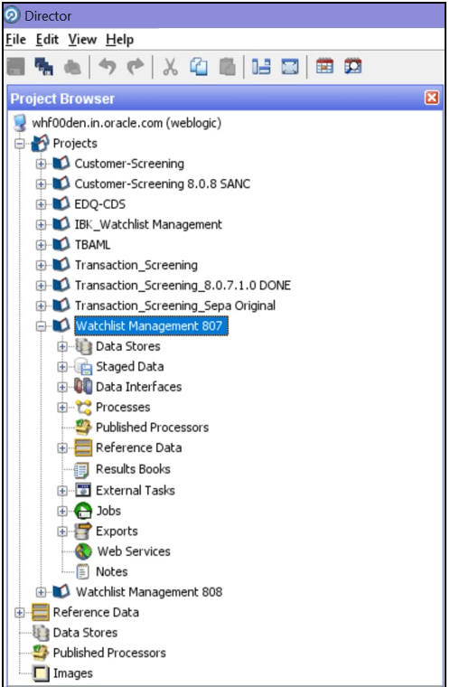

  2. In the Director landing page, expand the Watch list Management project in the Project Browser pane.
    Figure 4-40 Project Browser pane
    This image displays the Project Browser pane.

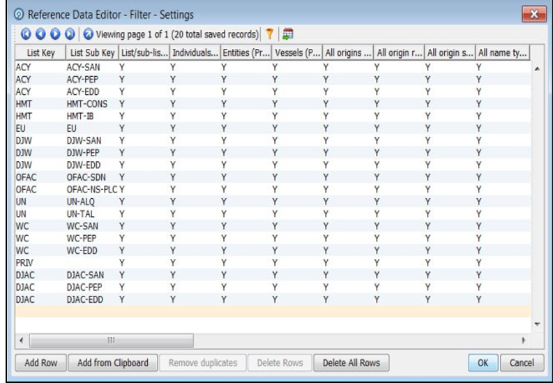

  3. Expand the Reference Data node and open Filter-Settings. The Reference Data EditorFilter-Settings window appears.
Figure 4-41 Reference Data Editor–Filter-Settings window
This image displays the Reference Data Editor–Filter-Settings window.
All the reference data filters except the Linked Profiles filter is set to Y by default. Unless these settings are changed, no actual filtering is performed on the watch list data. In the filter settings, a value of Y indicates that all records are included, that is, no filters are applied.
