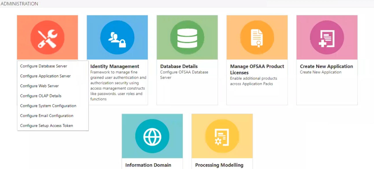

  1. Log in as a system administrator.
  2. Click System Configuration in the Administration page and select Configure System Configuration. The Configuration window is displayed.
    Figure F-5 Administration Page
    Administration Page

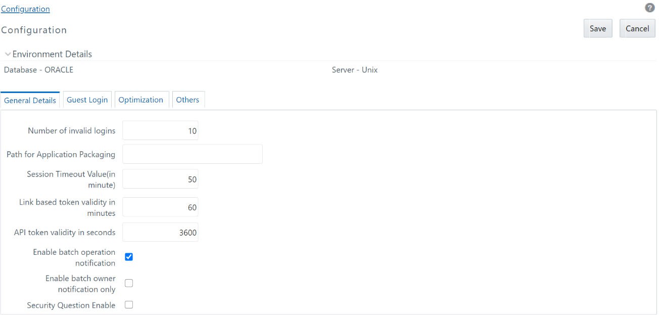

  3. In the Configuration window, change the token validity time in the API token validity in seconds field.
    Figure F-6 Configuration window with the API token validity in seconds field shown
  4. Click Save.
