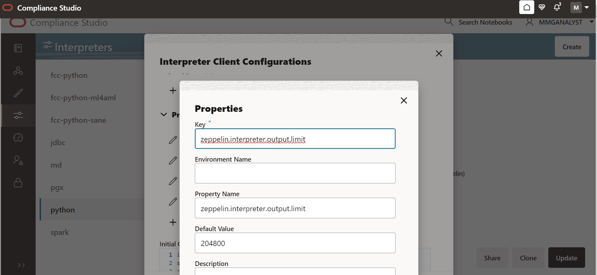

  6. Click the Wizard Wizard Icon Icon.
  7. From the RHS side, click oracle.datastudio.python.DsPythonInterpreter under Interpreter Client Configurations. The Interpreter Client Configuration pop-up is displayed.
  8. Under Properties, click +Properties. The Properties pop-up is displayed.
  9. Fill the options as shown in following figure. Set the default value to 870400 (for 1000 records approx.).
    Figure R-1 spring-postSacalert.properties file

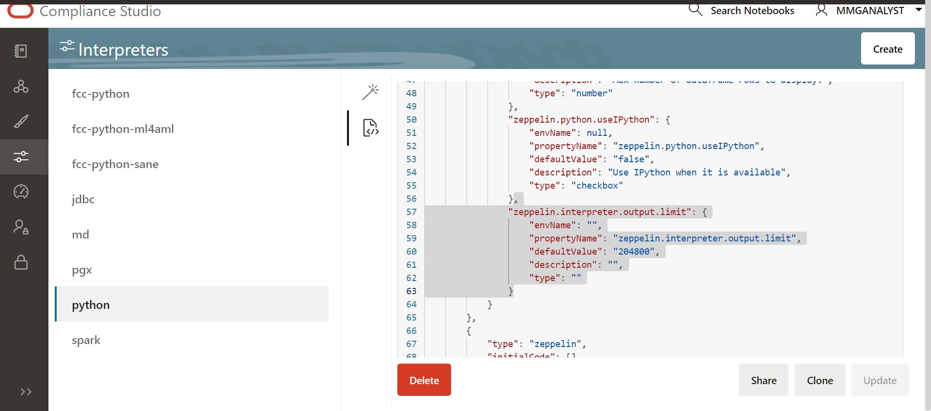

  6. Click the Configuration Icon Icon. The JSON configuration screen is displayed.
  7. Scroll down and locate interpreterClientConfigs with className oracle.datastudio.python.DsPythonInterpreter. you can find the properties section with zeppelin configurations.
  8. Add the zeppelin.interpreter.output.limit. See the following figure.
    Figure R-2 JSON Screen
    JSON Screen
  9. The update button will be enabled in the bottom right corner after the JSON modification. Click Update.
