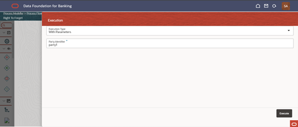

RTF process is user driven wherein customer can input party identifiers whose details are to be forgotten. Party Identifiers to be provided by the user through PMF input. Multiple Ids, if any, to be entered as comma separated.

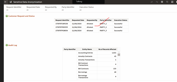

Following RTF information can be viewed in a Data Visualization (DV) report:
  • RTF Customer Request table would store details for every RTF request made with Party Identifier, requested by, requested date.
  • Once the RTF Engine PMF process is completed, the service would log the process execution completion status. If the Party is not available, then the service would update as "Not Available" and exits.
  • RTF Audit Log would store execution status of Right to Forget Run at the Entity Level with date and number of records affected.
Figure 4-1 RTF DV Report
RTF DV Report

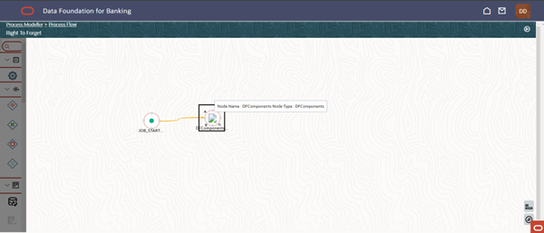

Figure 4-3 Factory Pipeline – Right To Forget
Figure 4-4 Process Flow
Process Flow

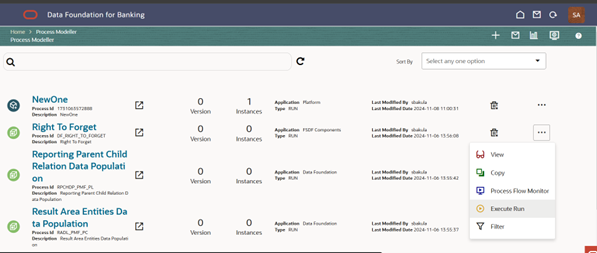

Figure 4-5 Process Modeller
Process Modeller
Figure 4-6 Execution
Execution

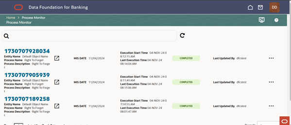

Figure 4-7 Process Flow Monitor

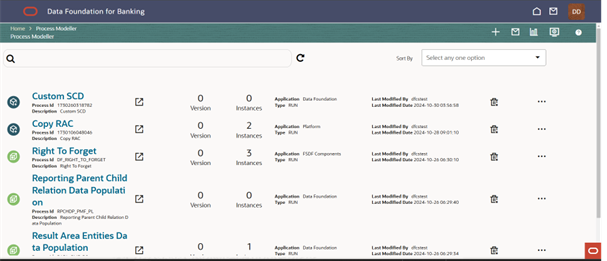

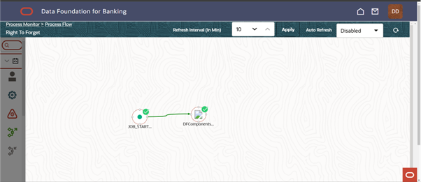

Figure 4-8 RTF Pipeline flow
RTF Pipeline flow
Figure 4-9 RTF Process flow
RTF Process flow

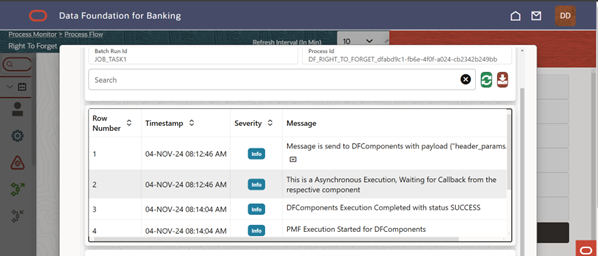

Figure 4-10 Execution Logs
Execution Logs
