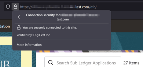

- Log in to the DFCS Application.
- Click the View site information/Verified by
Icon in the Browser URL Address Bar. - Select More information.
Figure 3-1 Certificates - More information
