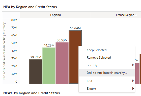

  1. Go to chart where user needs to see specific data -> Right click -> Drill to attribute/Hierarchy -> Select specific hierarchy for which user wants to view data.
    Figure 8-111 Drill through option

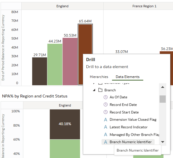

    Figure 8-112 Drill through option Data Elements
